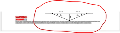

I am looking for a straightforward way to add my mathcad sheet to word. The solutions I found online haven't been working well or are not very practical considering I have over 200 pages on mathcad
maybe someone knows an alternative that works for my case
what I have tried so far is:
1. Copy Paste with Keep Source Formatting:
Does not respect page margins, even if I copy and paste page by page with both Mathcad and word with the same page size and margins:

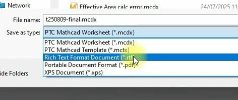

terryhendicott
Aug 12, 2025 1:30 PM UTC
Save As the Mathcad to rich text format *.rtf.
Microsoft word can open the rtf format.
Cheers
Terry

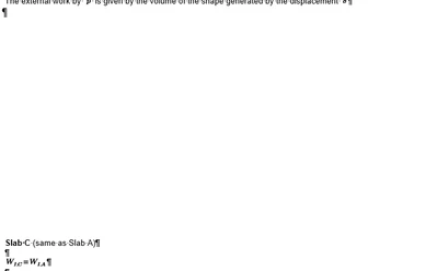

netoprax10-MarbleAuthor
Aug 12, 2025 7:24 PM UTC
I just tried the RTF and for some reason it creates some page breaks at weird locations, and when I try to delete them, this happens:
a huge blank space I cannot delete
any advice on how to fix this? thanks
Aug 12, 2025 7:28 PM UTC
if there is a way to get rid of these page breaks, this solution can actually be good
the issue I have now is that for some reason I have some spots with page breaks resulting in One or Two blank pages, and when i try to delete the page breaks, a lot of stuff moves around.
