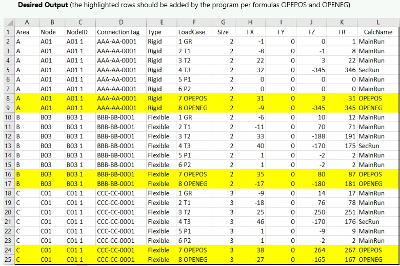

I have a new question for you that should be straightforward. I'm wondering how write a program to add additional rows to a matrix, where the values of the elements are calculated according to a formula using existing data within the matrix.

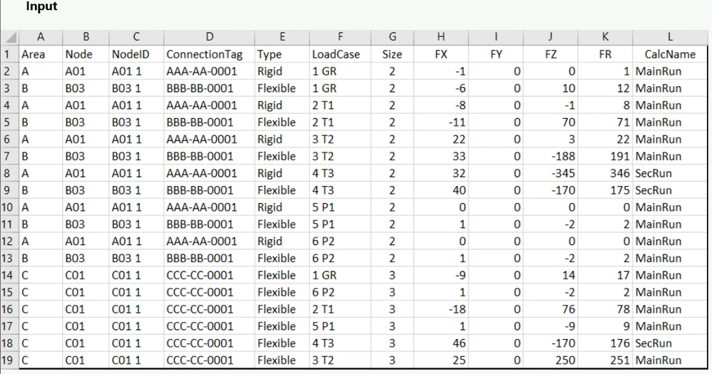

The attached Excel file includes a tab with input for the ReadExcel function, as well as a tab showing the desired output by a writexcel function. Essentially, the matrix is a list of node point IDs with force vectors due to six load cases. Each node ID will have the same number of load cases and the input will be always sorted by LoadCase column. I would like to add new rows for each node ID, namely 7 OPEPOS and 8 OPENEG, using a specific formula which pulls its input from the existing data within the matrix.
Input for the readexcel function:
Desired output by the writexcel function:

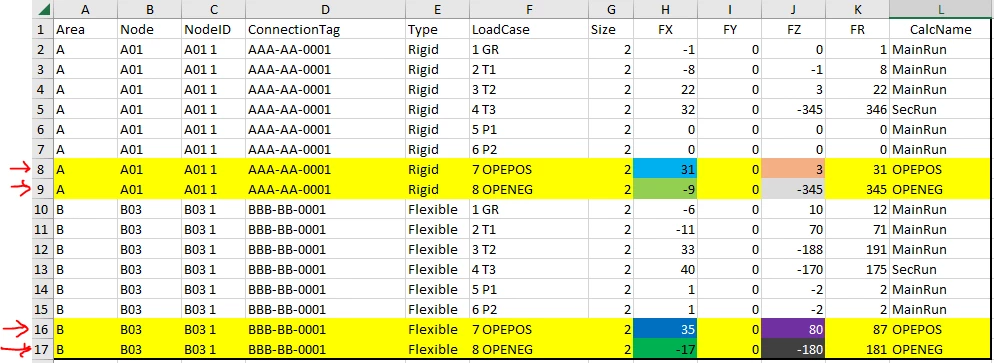

Rows 8, 9, 16 and 17 should be added by the formulas:

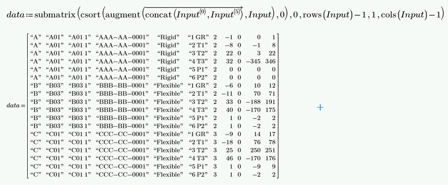

My first approach would be to read the data from your excel sheet into a matrix in Prime. Then add the rows to the end of the matrix. Then sort the matrix (columns A and F might make a nice couple) then write out the resulting matrix to excel..

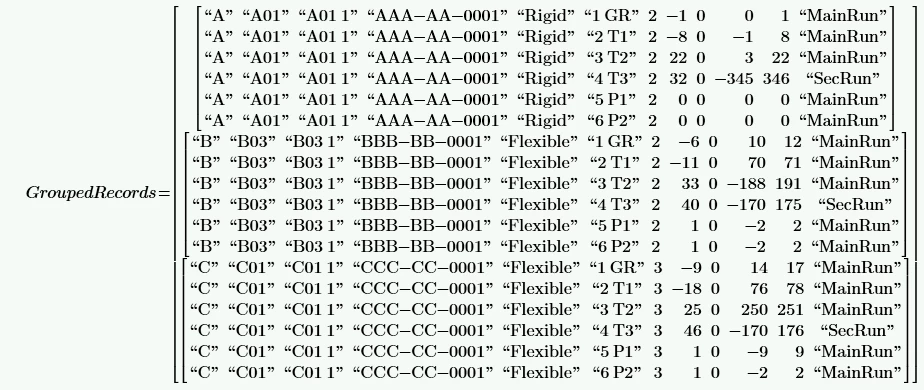

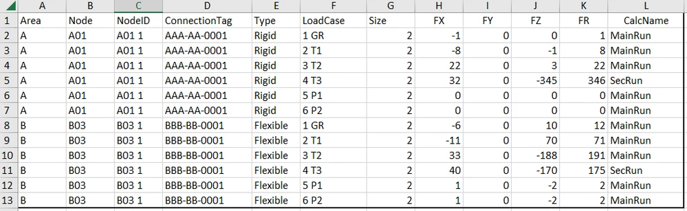

I was able to read the raw data and then sort the matrix in groups of NodeIDs.
I can take it from this:
To this:
Where I need the help is to insert two rows for each group with the calculation of OPEPOS and OPENEG for FX, FY and FZ columns.
FR is the resultant force calculated by the square root of the squares (FX^2+FY^2+FZ^2)^1/2.
The desired output should be like this:
The formulas for OPEPOS and OPENEG are in the MathCAD worksheet so you don't need to type them from scratch.

Here are my 2 cents, but I used your original Excel input file.
The solution is unlikely to win a contest for beauty and elegance, but so what ...
To use the new unsorted Excel Input file, you would first have it to sort for column F and then for column A.
You may do it in Prime, too, but you have to take care because the built-in "sort" function would not leave the order of the sorted column F intact when you sort for column A.
There were posted sort functions here quite a while ago which would do so, though.
But you may also use the grouped record you already created and stack them so you get the needed single matrix.
You may also use a command like the following
But I just notice that your new Excel file is missing some of the columns which were present in the first one you posted, so you would have to change my ProcessData( ) function accordingly - guess you will see where changes are needed.
