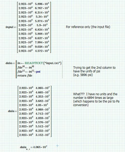

I'm not sure what's going on here.  I'm reading in a file and trying to get Mathcad 4.0 to add units to a column.  But it's not working as planned.  Tried a few different variations but always get the same issue.  What am I doing wrong?
DJF16-PearlAuthor
hmm.  I guess using READPRN gets it to work.  But it seems to have no problem using the values read in through READTXT for anything else (e.g. math operations work fine), so I'm not clear on how or if it sees them as a different variable type.

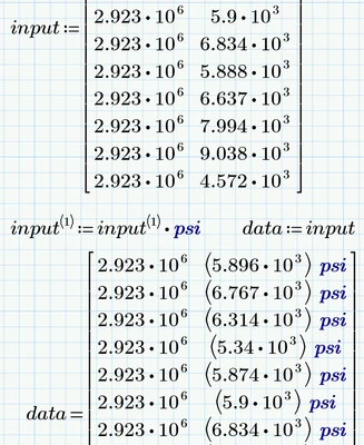

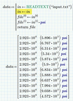

A workaround is shown in the picture:
A shorter version is
May be it is one solution
