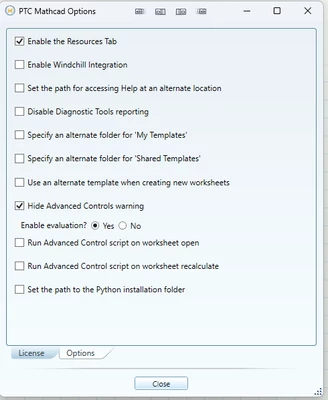

So I'm comparing two test List Box examples (the JScript example in Help https://support.ptc.com/help/mathcad/r11.0/en/index.html#page/PTC_Mathcad_Help/example_listbox.html# ).
Mathcad Prime 10.0.1.0 retains the selection after saving and closing when you remove the ListBox.CurSel(0); from the example, which you did, wisely. That's all. You may have whatever option selected you want. This matches up with your experience.
Mathcad Prime 11.0.0.0 will only retain the selection after saving and closing when you both do that and you disable the "Run Advanced Control script on worksheet open"  option in PTC Mathcad Options. Do you have that option disabled?

So, I've been testing by saving and closing repeatedly as I've been trying to update my MCP10 scripts to get this to work, but haven't had any luck. Also, I first realized this issue when I opened a MCP10 file (w/ the working script) in 11 and all my list box selections were reset. So, the 10 file had already been saved and closed. And, yes, the "Run Advanced Control script on worksheet open" option has been disabled as a default (I've never used that one). What else do you think I am missing?

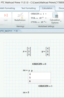

Update:
PTC has released 11.0.1.0 which partially fixes this issue. The previous v10 behavior has returned where Advanced Controls List Box selection is preserved. HOWEVER, there is one giant caveat: this only works when the ORIGIN is set to 0 (it does not work with ORIGIN = 1).
Users can assign ORIGIN to 0 above an AC and then reset it to 1 if they'd like, but the AC will only work the intended way with it set to 0. Example shown below.
