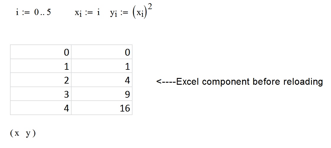

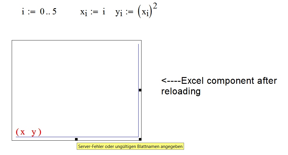

Hi, I'm using a win7 professional 64 bit with Excel 2010 and Mathcad 15. After updating Mathcad from M020 to M045 the Excel components in an existing Mathcad worksheet no longer work. Additionally, if I insert a new Excel component, it seems to work, but after reloading the Mathcad file, the same error occurs: server error or invalid worksheet name specifided.m045error.jpg

Here is the sample file.
January 20, 2016
I see the same problem with your file. If I create an Excel component, save, and load again, I don't see the problem. I have the latest version of Excel though (and M045).
