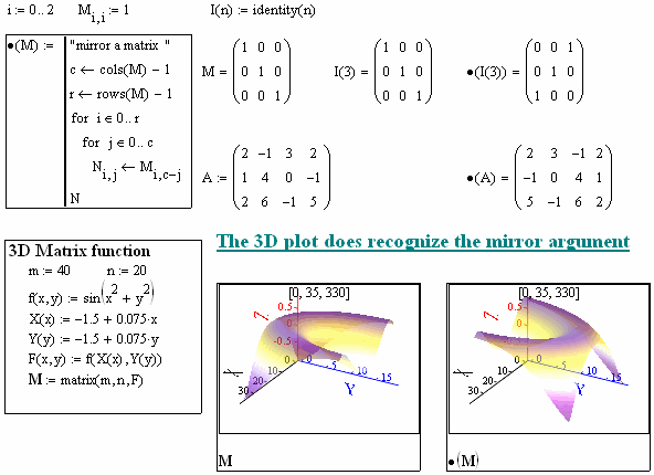

In reference to Stuart last working "Aggregate", what about having an optional reverse indexing, i.e: a mirror indexing. The optional reverse indexing being from an identifier of some kind.
That would duplicate the functionality of the proposal.
jmG
January 15, 2010
... a letter would make easier for the mirror.
Glad the 3D recognizes the mirror argument !
