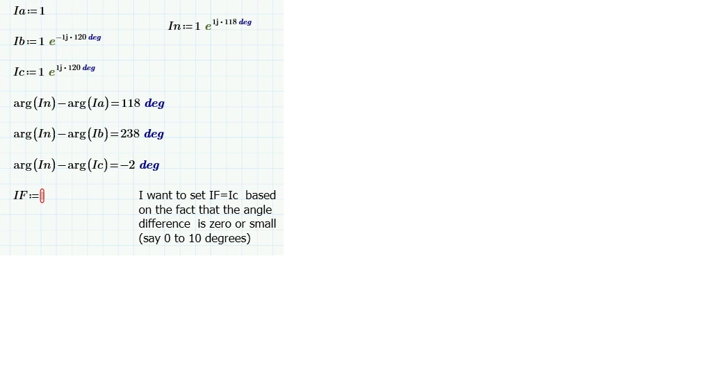

How do a allocate a variable to another variable based on conditional check?
Attached a picture and Mathcad Prime 4 file.
Thanks.

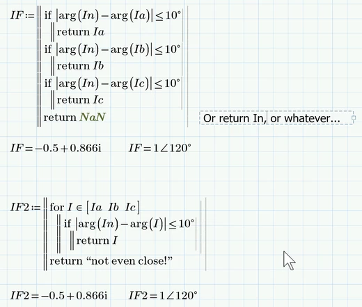

You're not being very clear:
What 'difference'?
And what do you want IF to be when the 'difference' is > 10 degrees?
I could assume a thing or two, but I'd rather start on clear input.
8-Gravel
Catch it.
Something like this?
18-Opal
Essentially I have 3 columns of data.
These 3 columns of data are individually  compared with a fourth  column of data.
Once I find the column of data whose angle  is close to the angle of the fourth column I want to allocate that column of data to a  variable IF.   The new column of data is now IF .
Regards
Werner_E25-Diamond IAnswer
So it looks that my guess was correct!? Can you confirm?
So all thats needed is to apply it to a whole column of data which you would have to provide in the first place.
