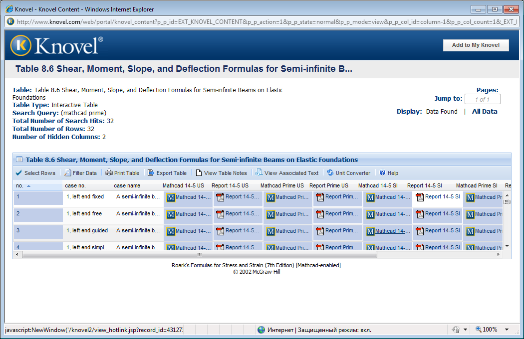

For a long time our engineering department relied on Mathcad and the Mechanical Engineering Library addon, mainly for Roark's formulas. However, in our recent migration to Prime (for Windows 7-64 support) we thought we'd be able to get the same thing by subscribing to Knovel's Mathcad worksheets. However, it seems Knovel's subscriptions for Mathcad has been very recently been discontinued and they are no longer offering new subs (current subs are slated to be discontinued next year). Converting old worksheets to the new Prime format is possible, but they aren't pretty.
Do I have any options here?

Sorry, Roark's formulas was converted into Mathcad Prime:

Mona - Thanks for the reply. However, I can't get access to Knovel as a new Prime customer. They aren't selling subs anymore to get a login to their mathcad content.
Fred - Being able to open the handbook in 15 is something I haven't tried. I'll check it out.
