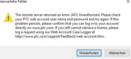

Always Getting Error 401 During Licence Activation (Student)
I always getting this error (picture below). I want to activate my Mathcad 15 but it wont work. My user account won't work the Licence Code is working but then comes the Login and I'm getting this error. What can I do to fix this?

Can you log in to your PTC account (not these forums, but your actual PTC account)?

did you already succeed to solve this problem, as I'm experiencing the same, although I have no problem login in to my PTC account.

That is not correct. Your license is locked to the MAC ID of your primary network adapter. Mathcad does not link to any server to verify that the MAC ID is the same as the (latest) one PTC has on record. If you want to migrate Mathcad to a new PC then you need to log in to your PTC account and migrate the license to the new MAC ID. Despite what "move a license" might imply, this does not kill the copy of Mathcad on the old PC (although using it on both PCs will violate the license agreement). One reason you might be getting the 401 error during licensing is that your copy of Mathcad is not linked correctly to your PTC account. If that's the case, then you can't enter the license manager, hence "Unauthorized'. You can easily check this just by logging in and trying to go to license management. If it's not correctly linked, open a licensing case and PTC will fix it for you.
Simply starting Mathcad on your desktop PC could not give you a 401 error from the PTC server. It does not try to link to the server during launch.
