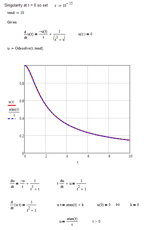

I recently learned about the following problem, whose solution function u(t) requires determining:
u´(t) = -u(t)/t + 1/(t^3+t), u(0) = 0
I intentionally called this problem a riddle 😉 .
Please answer in MC14-readable format.
Mar 14, 2025 11:15 AM UTC
There is a singularity at t=0, so:
(Done in M15, but I think M14 can read it).
(Actually, the limit, as t tends to 0, of atan(t)/t is 1, so more sensible to set u(0) = 1.)

The limit eps-->0, like t-->0, yields the ordinate u(0) = 1. Therefore, the differential equation with the required initial
value u(0) = 0 has no solution?

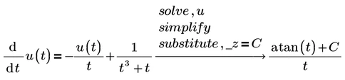

The general solution (without an initial value) is:
u(t) = C*1/t + 1/t*arctan(t).

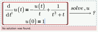

From a math point of view you can't demand u(0)=... because of the singularity mentioned by Alan.
I am not sure if you could demand
and how we would handle this constraint.
Prime is able to solve some simple ODEs and so it can come up with the correct general solution (valid of course only for t <>0)
When asked to solve the ODE with the (forbidden) IC u(0)=0 it happily comes up with a wrong solution 🙂
but
And here a last 'interesting' result given by Prime
Hmmm ....
