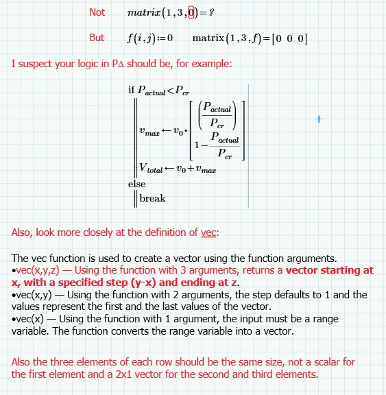

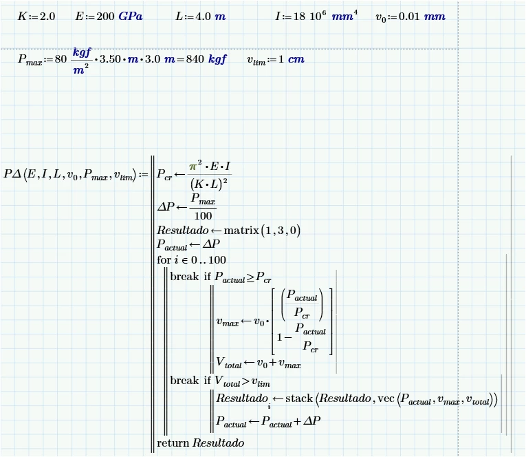

Hello, I'm having trouble developing a loop that includes break and return statements for buckling analysis. I'm also having trouble generating a combo list for the K values.
Jul 19, 2026 8:13 AM UTC
There are a few errors:
