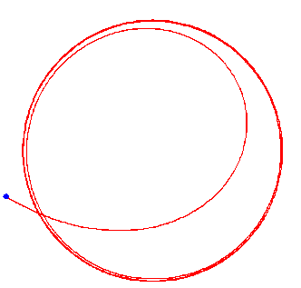

Animation of an x-y diagram
Again, here I am asking for help in animating a chart. I can't get a moving dot/symbol moving on the red curve. In particular, I am not able to successfully define the symbol and its movement parameters in the diagram.
Kind regards, Alfred Flasshaar
Werner_EAnswer
The attached file should help!
11 replies
Werner_E25-Diamond IAnswer
Here is a slight variation
(The predrawn red dotted path was partially 'deleted' by the conversion avi->gif. See the attached original avi for comparison.)
Thank you very much. Apparently I'm too clumsy with software. This illustrates the solution of a modeled tracking problem: "Monthly Notebooks for Mathematics", Volume 64, Issue 4, Page 305, 1959.
