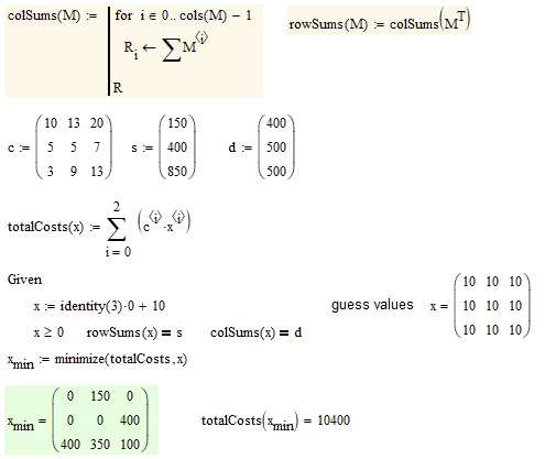

Hola Werner,
I am attempting to determine optimal transport program, so that total transport expenses would be minimal.
I want to use simulated annealing to minimize. The theory of the optimal transportation program is attached in the pdf document.
The data being applied is presented in the image.
Any help you can give me will be greatly appreciated.
CarlosRomero
Werner_E25-Diamond IAnswer
I can't be bothered implementing the annealing algorithm in Mathcad, but here is how I would do it using a solve block with minimize().
