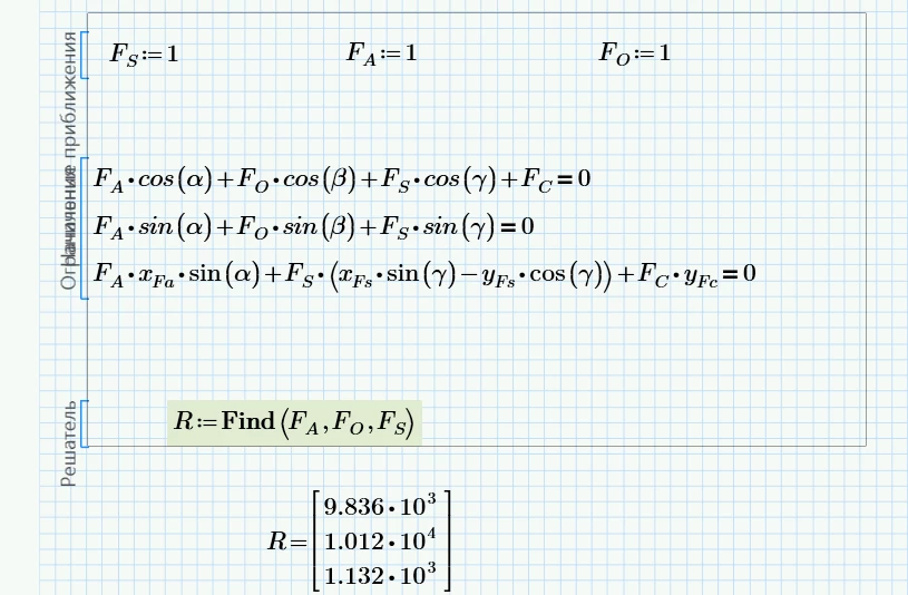

Hi

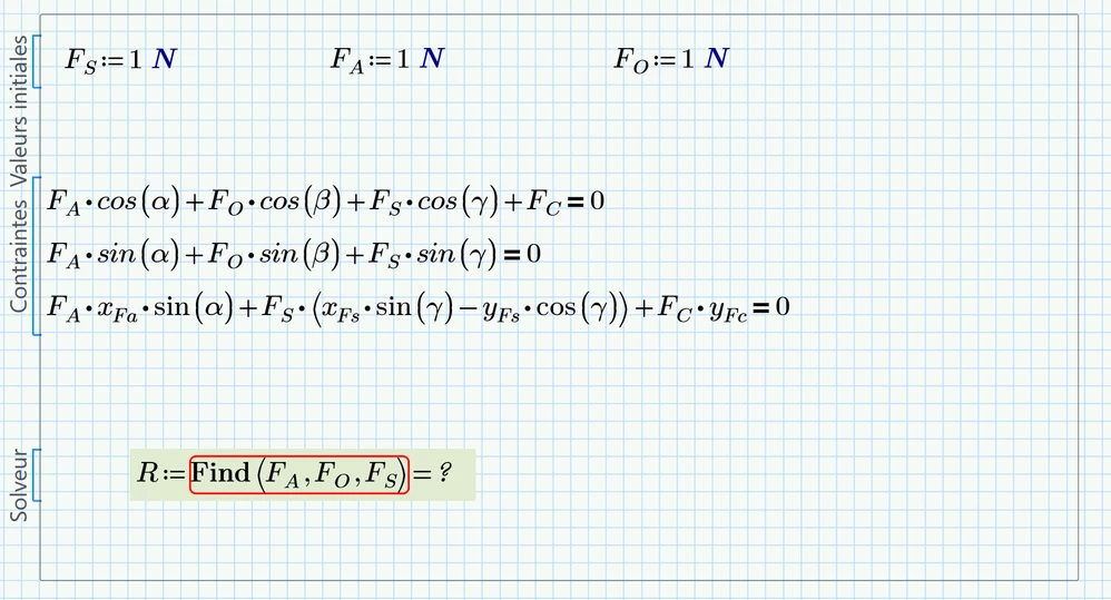

I make a very simple sheat (mechanical problem), i don't understand why blocksolve  fail ?

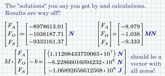

I can to solve it with my hand and paper.  For example , i find with my hand:
FA = -8978613,01
FS = -1038187,81
FO = -9333161,37

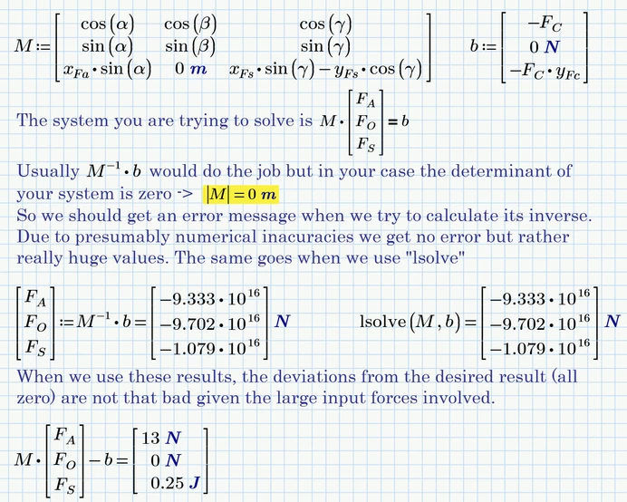

Aug 21, 2025 1:53 PM UTC
Your system is inconsistent! Its coefficient determinant is zero. That's the reason you get no solution from the solve block with "find".
Also I wonder why you are using positive guesses when you expect negative results.
And why guesses of a magnitude of 1 N when you expect results in the range of a few MN ?
It looks to me that you did not check the results you got by manual calculation against the given three equations, right?
The results are far off!

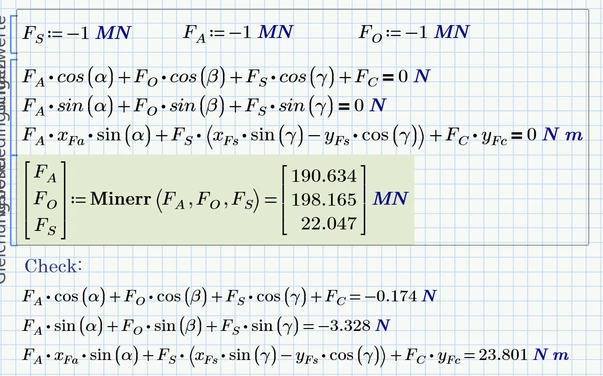

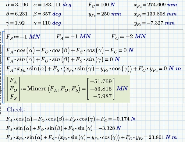

I guess that there may be an error somewhere in the derivation of your equations,, but if you really want to use the equations as given, you could use "minerr" instead of "find" to get a solution with overall minimized deviations.
But you have to be aware that even slight changes in the guesses may result in huge differences in the results!
Just changing the guess of F.O from -2 MN to -1 MN turn all results into positive values. Nonetheless the check shows similar results.

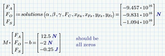

Aug 21, 2025 12:47 PM UTC
In Mathcad 15 it is like this.

yes it's the same order of magnitude as my manual calculation (I make approximations) but I don't have the real mathcad unfortunately. I don't understand what's wrong? the goal is to find a geometry that minimizes FS... I'll have to do everything in iterative mode with excel if this continues...

Remove the dimension.
Werner_E25-Diamond IAnswer

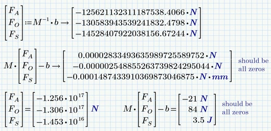

Aug 21, 2025 3:20 PM UTC
It seemed to me that your system is inconsistent and has no solution at all because it looked like the coefficient determinant is zero with the values given.
I tried to evaluate it using symbolic calculation and it looks like its not zero but very close to.
We even get a similar (but slightly different) result with numeric calculation as well if we let display the result in mm
So even when we use the symbolic engine to solve we don't get an absolutely correct result and I guess forces with a magnitude of 10^17 newton are of no value to you:

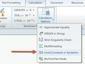

BTW, in case you want to experiment with the symbolic engine yourself, you have to define the unit "deg" in front of the sheet
because the symbolics does not know anything about units and you have to enable the option shown in the pic below to ensure that units stay labelled as units in calculation results.

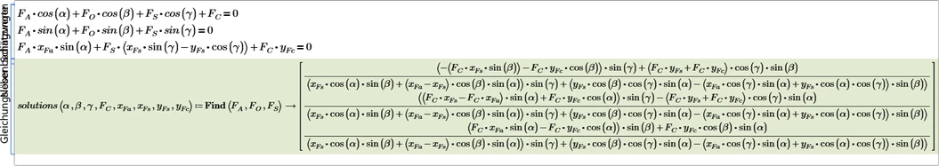

You may solve the whole system symbolically. Simply clear the input variables for symbolic use
and either use symbolic evaluation with "solve" or your solve block (no guesses necessary) to get a symbolic solution:
As you can see I turned the solution into a function of the input variables which can be evaluated numerically using the specific input variables you calculated (they were only cleared for symbolic use but still kept their values for numeric calculations).
You can check using the symbolic result and the numeric values provided that the denominator of the solutions (all the same for all three result and its the determinant of the coefficient matrix) is incredibly small, hence the huge result values.
I would therefore say that, although the system is solvable from a mathematical point of view, in practice it must be considered unsolvable and too unstable.
