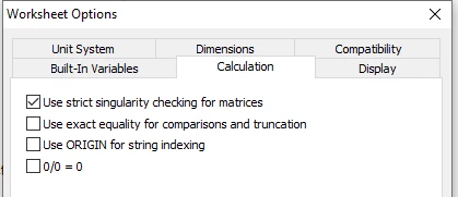

Mathcad 15 is correct you just need to look at more decimal places.
It also pays to try checked or unchecked the use exact equality option
Cheers Terry
November 27, 2019
Cheers Terry

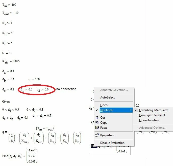

November 27, 2019
but the answer is only one or range?
November 27, 2019
Hi
"but the answer is only one or range?"
Not sure what you mean.
"Find()" is a minimization routine that seeks one and only one solution based on the guess values you choose.
Different guess values could find a different solution but only one solution.
What do you mean by "range"
Terry
