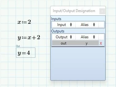

Let say my worksheet has x:=1 and y:=x+1=2. What function can I use to get the y value?
First express y as a simple display value:
   y=
This will display y=4
highlight it and select Input/Output | Integration | Assign Outputs
A small blue box with the title Out will display around y=4
Note it is the first output and I have manually changed the alias text to y
Dim y As String
Dim y_val As Ptc.MathcadPrime.Automation.IMathcadPrimeOutputResult
Outputs = WS.Outputs
y = Outputs.GetAliasByIndex(0)
y_val = WS.OutputGetRealValue(y)
Cheers
Terry

terryhendicott
May 24, 2022 12:54 PM UTC
y_val has three members
y_val.ErrorCode      an int32
y_val.RealResult     a Double
y_val.Units              a String
