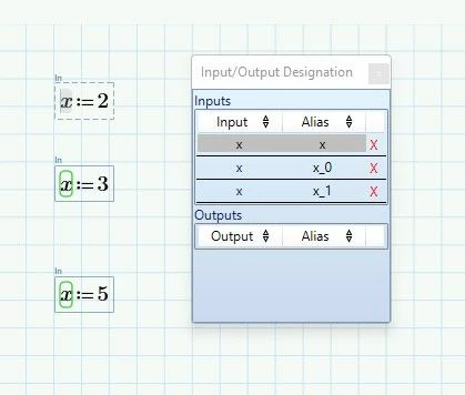

If you have more than one input defined for "x" the alias that you can use to differentiate between them will automatically be different.

terryhendicott
May 21, 2022 4:53 AM UTC

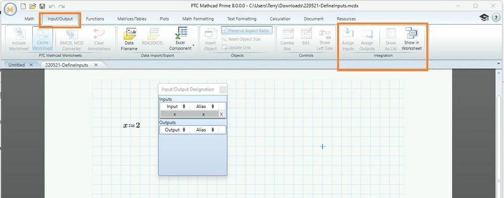

Asked to see the worksheet to see if input or output had been assigned.
To change the value of an item and its units in VBA/Prime value needs to be set as an Input parameter in the worksheet.
Highlight x:=2
Assign Input will no longer be greyed out.
Press it and a small blue box with "in" title will be visible every time you highlight x=2.
Use Show as list button to show the defined inputs and outputs.
In Prime
Cheers
