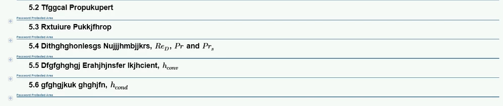

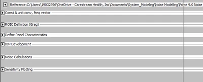

MC15 allows a label to be added to an area, so when it's collapsed the label can be seen. In Prime 9.0 I can create areas but can't figure out how to add the labels.  In MC15, when I collapsed all the areas, the labels showed the analysis/calculation flow which is real nice. Is this functionality lost in prime?

Yes, the possibilities to format an area (labels, color, ...) are much more limited than we were used from real Mathcad. Maybe PTC will add some of the old functionality in future versions of Prime.

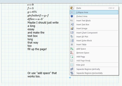

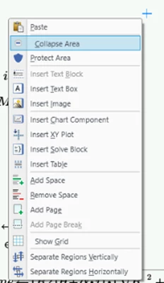

Regarding the uncomfortable part, you can right-click to open the right-mouse button context menu within the bottom (or any empty space) inside an area to collapse it. It's an alternative to pressing the minus button at the top left corner of the area.
For example, an area so long that you can't see the minus button within view:
You would need to scroll up to the start of the area to expand it, though.

Thanks for pointing out the right click menu. Even if it is not necessarily intuitive, this functionality is still very helpful for larger areas!

You may need to place a text box near the area before collapsing it. However, this process may not be as streamlined as in MC15. If the area is too large, instead of scrolling all the way up to press the minus symbol to collapse it, right-click in any space within the open area and use the context menu to select "Collapse Area."
Below is an example of using text boxes for labels:
