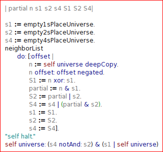

I have a correction to my last response. The final equation is not correct, because I assumed a "don't care" state in the truth table that must have the value of true in order to work.
This changes the last S4 assignment. I found this error when I actually wrote a quick and dirty program in Squeak Smalltalk. It works fine once I got the truth table debugged. I intend to look into writing it again for Mathcad using image processing just for fun.
Here is the actual code from Smalltalk. It shows the power of a real Object Oriented language as I implemented Boolean operations which operate on 1000x1000x1 bit map images using BitBlt operations. Here is the actual logic code which works correctly. It is not optimized so I am looking to minimize the number of Boolean operations, each of which operates on a million pixels in parallel. The speed is not great. I get about 8 generations per second on my lap top. But that is with no optimization, and I know I can make it much faster just by cashing object instances and working with profiling. I have demonstrated speeds 10 times as great in a Bitblt loop test. Also,there are lots of opportunities to optimize it. Not only that, if I get access to the 70+ Graphic Processing Units on my high end graphics card through Open GL or some such the I can get some real speed.
At present I do 50+ BitBlts per generation. That is more than 50 million brute force bit Boolean operations per Life generation whether any state changes or not, like in empty space. Golly using HashLife, sometimes can get 10^7 generations per second using a very sophisticated hashing scheme.
Below is the code for the main execution loop which carries out the complete of the Game of Life logic as Boolean operations. It is quite impressive once you understand each variable actually holds a million bits, each of which is operated on in parallel in the Boolean operations. Clearly there is more optimization to be had. For example the first time through the loop all the boolean operations are unnecessary as they are operating on zero value 2D space meshes.
