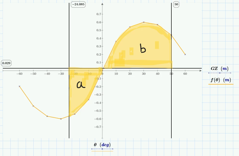

area between markers and curve
I've shaded a portion between markers and curve as one portion as a other as b, how can i find area between them.

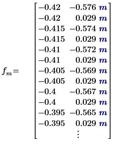

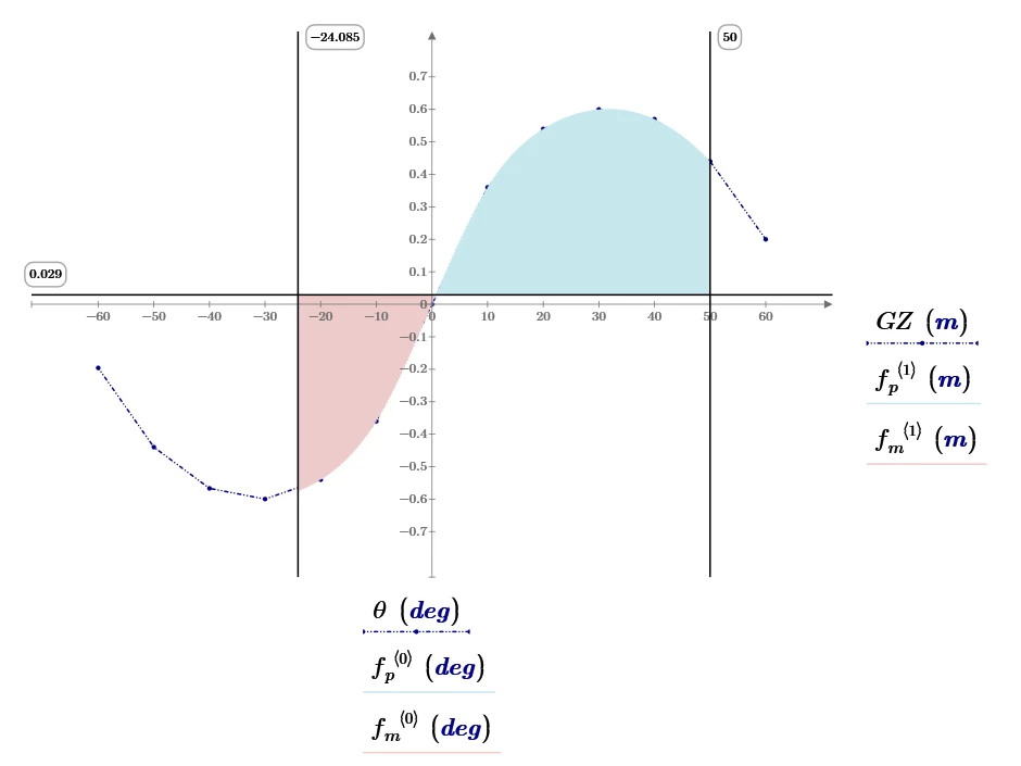

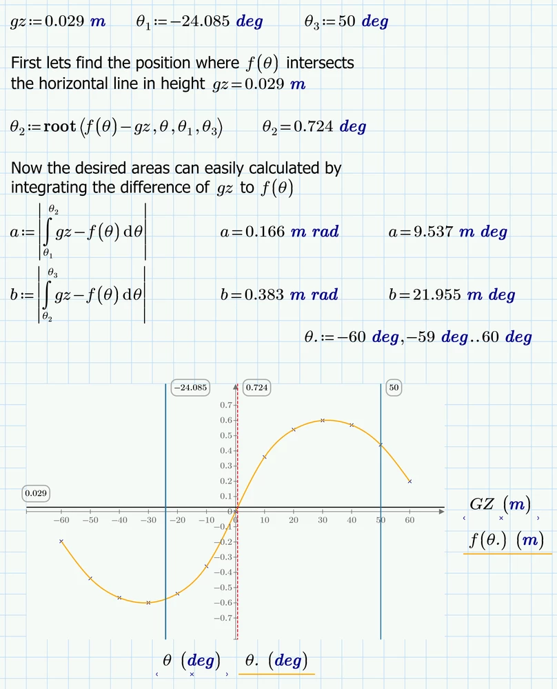

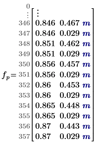

Maybe that way
Keep in mind that the "area" is of dimension length times angle. Probably you are interested in the value with meter times degree.
Prime 9 worksheet attached
