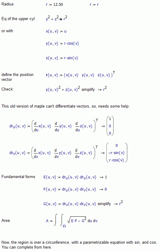

Hi Niels. I can't read your attached, but must to try something like this

Alvaro,
I resave the worksheet for Mathcad 11 version and in PDF file format as an attachment.
