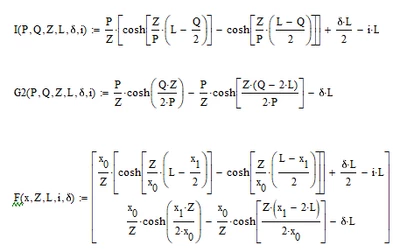

Hello Experts,
Somehow I am getting error in Mathcad Prime but it used to work with my 14 application

8-Gravel
April 29, 2022
@StuartBruff @terryhendicott
Thank you for engaging . The value entered in prime is not required to be instated in Mathcad 15. See attached
Why we need to enter values in prime?

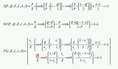

This is your Mathcad 14 file:
And this is what you have in Prime 8:
Note that in the second function of F you have an H that should be an x[0
That is one thing you need to fix.

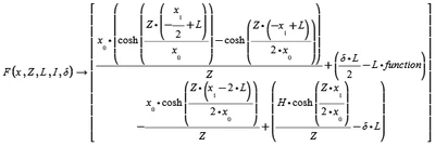

Then, symbolic evaluation of F itself gives:
Which demonstrates that Prime 8 has a bug where it fails to see I as a parameter to the function F, it is confusing it with the function I() that you defined above.
Finally you're running into autolabelling problems. Make sure all your variables are labelled as a variable, and your functions are labelled as a function, then see what happens.
I got this:
I'm afraid this does not make you happy.
