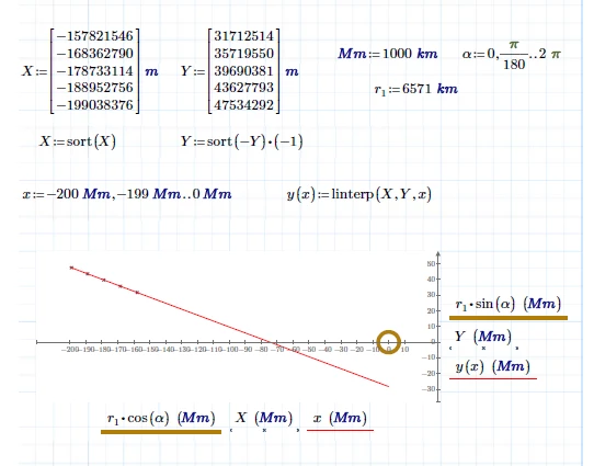

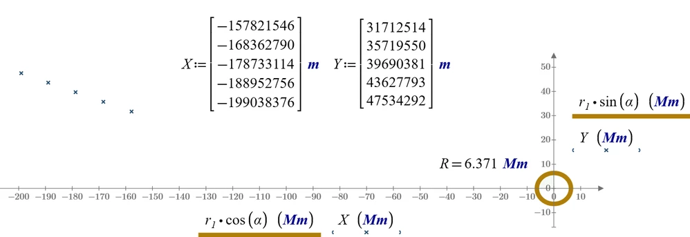

Thanks, but NO!
We have 5 points not 2!

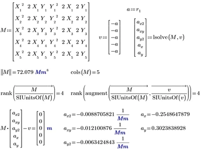

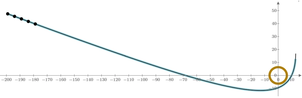

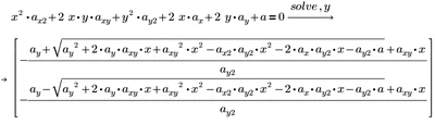

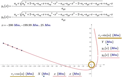

My solution. Do you have more interesting? more correct?
One question - rank1=4 rank2=4 cols=5!!!
Hyperbola, ellipse, ParabolaHyperbola, ellipse, ParabolaLsolveLsolvePlotPlot
