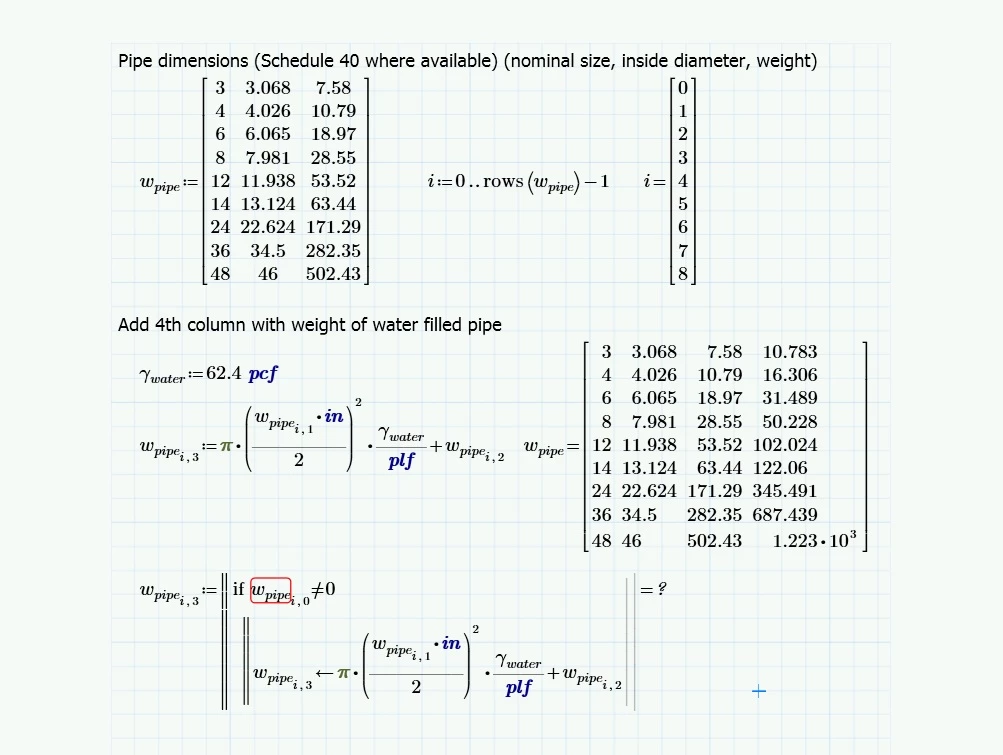

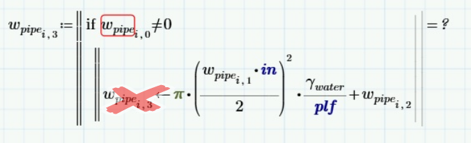

Array column creation with if statement?
The attached Mathcad Prime 3.1 worksheet (and screenshot) adds a 4th column to the array (or is it a matrix?) with the weight of pipe filled with water per foot. Creating the forth column with a definition works. The if statement tries to accomplish the same goal, what am I doing wrong?
Werner_EAnswer

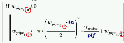

Either use a different (dummy) variable instead of w.pipe[i,3 or even better omit the local assignment and use just the right hand side expression on its own.
You should also add an else statement in case a value in the first column is zero.

Werner_E25-Diamond IAnswer

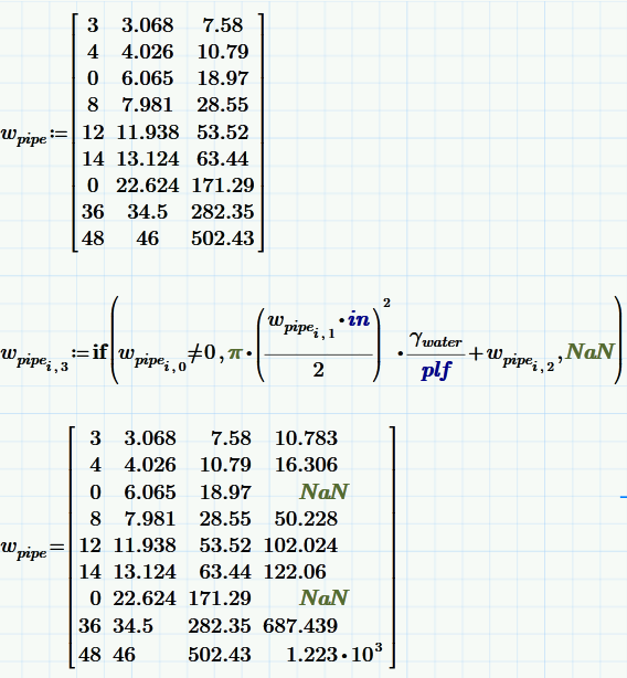

-MFra-
you can do so too:
to which is added the case where w = 0
dsochor1-VisitorAuthor

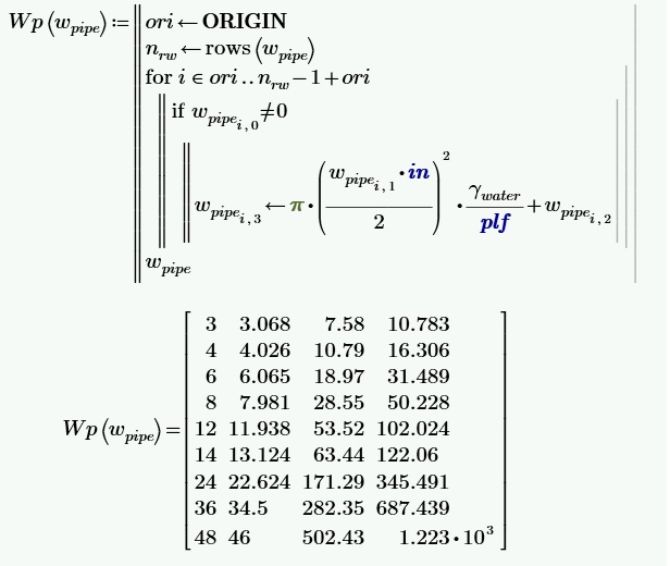

Thank you both very much. F.M. that's a clever way to handle a 1 or 0 Origin.
Yes, but to be fully ORIGIN-independent one has to change the second indices 0,1,2,3 to ori, ori+1, etc., too. Otherwise you will run into an error in case ORIGIN is not 0.
BTW, here's another way to achieve what you want using the if-command. I changed two values in the first column to zero to show the effect of the "else"-branch.

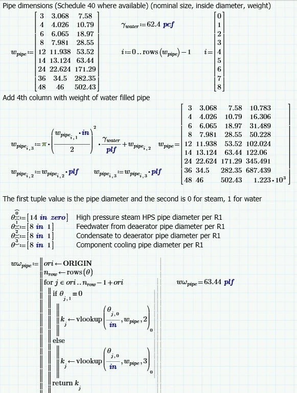

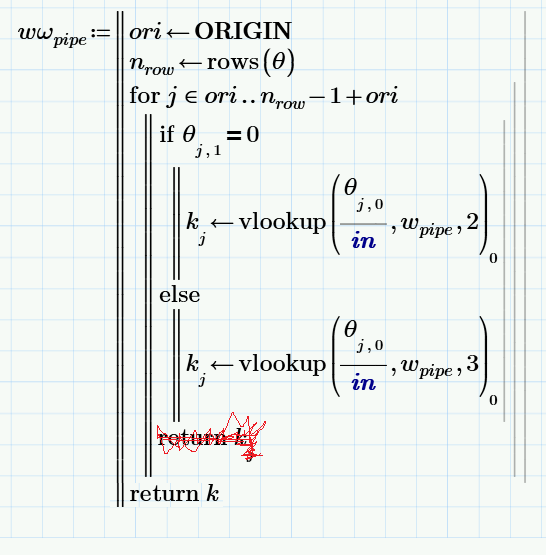

A quick question; what change do I need to make to the last program return a vector of values instead of a single value?
23-Emerald V
I think this should work to get the full vector of k-values:
Thank you!
