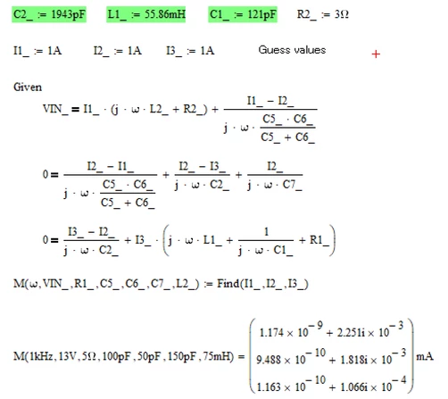

Hello everyone
I want use array in solve block.
I attached file "test2".
But I have "pattern match exception" error...
I also try without array.
I attached file "test1"
I have also error, but I can use this result.
Please advise on this difference.

Unfortunately a solve block won't work with vector elements.
BTW, why use symbolic evaluation and why are you stripping the units?
Guess its faster an better to use numerics with units:

It is a pity that arrays cannot be used in solve blocks.
This solve block result is used to find the frequency and
some component values ​​in another solve block later.
(1) Make it look simple I thought I used an array.
(2) In order to obtain variables including units
  with different frequencies and component constants
in the solve block at the latter stage,
the unit is intentionally omitted.
