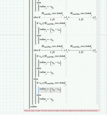

I am trying to build a Mathcad sheet to find pile capacity. The maximum number of soil layers available is nine (9). The user can choose to use all or, some of the layers within this 9. I am trying to build a logic to assign unit weight based on the layers I have subdivided to. The issue is if all layers are not being inputted, then the logic for unit weight says "Array Index invalid". Please help on this issue, my version is Prime 10.

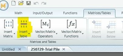

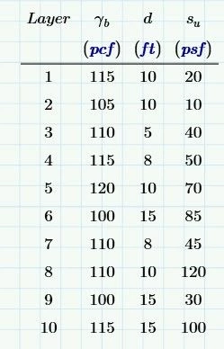

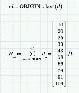

I suggest an input table like this:-
Saves the steps turning input into vectors as the table creates them.

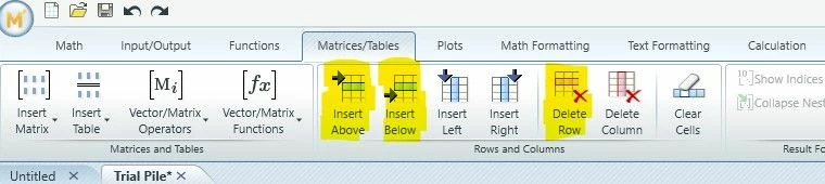

Rows for less or more layers in a problem can be easily adjusted and sheet corresponds to these changes using last()
Assigning depths of the layers is trivial
As is finding the layer the pile stops in
Cheers
Terry

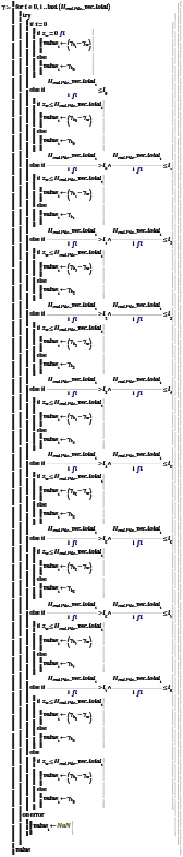

l is only 0 to 2 index. So use Try on error and get below result.
t.t.

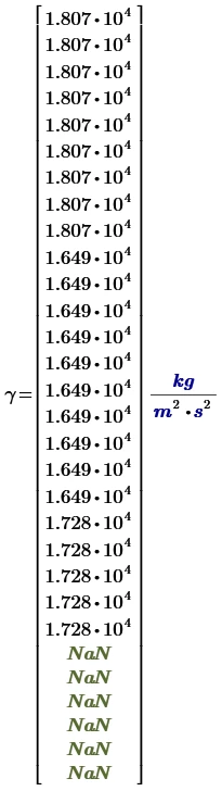

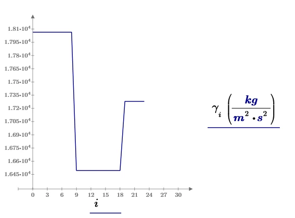

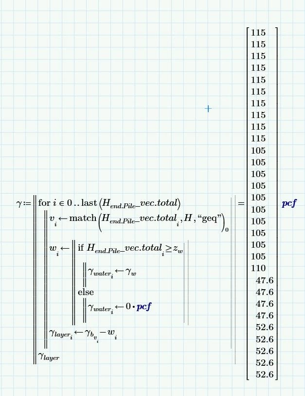

Now for the second part getting the value of Gamma.
Setting the water table in the depth of the pile for demonstration.
Gets the following Gamma
Cheers
