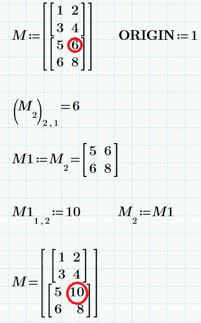

Does some one coulp help me with the syntax to set a value to a matrix' element in an array of matrix?
On this example AA is an array/vector of 2 matrix 5x80.
I can access to an element to get his value (67.34) but I am not able to set a value to this same element.
Maybe the syntax I use is incorrect..
Please Help !!!

I think it is a bug in Mathcad.

Thanks for your answer.
I understand your demonstration but this is not applicable to intense matrix computation...
Is there a way to repport this bug to PTC ?

You can push a value into a matrix with a program.  It's quite cumbersome

Jean-Marc,
If the links do not work for you, please let me know and I will enter the bug.
I believe it will have more weight coming from a customer, but will get it on the books for you.

This problem has been known about, and complained about, for years. Long before PTC even acquired Mathcad. Since it hasn't been addressed in the last 15 years, it will be interesting to see if it gets addressed in the next 15 years.
