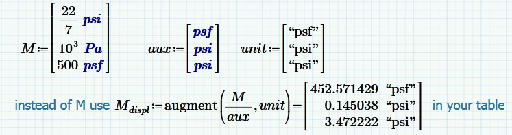

Yes, thats the behaviour in Prime at the time. Values in arrays are displayed using standard default units only. This could only be overruled if every value in the array has the same dimension and should be displayed in the same (non defaut) unit - then you could set the display unit after and outside of the array.
Only "workaround" I could think of is to strip the units in the column by deviding by the unit you want to see in the display and add the units as text (looks pretty ugly):
2) The RF column needs to be displayed as 2 decimal places but not the allowable or applied columns, these need no decimal places however, when I select the value or the column I need to change and then change the number of decimal places to be displayed, it changes all values in the array not just the column or value I have selected within the array?
Setting for number of decimals displayed only work for a whole math region, not just parts of it.
Possible workaround is to use the "round" or the "Round" function to cut down the number of decimals for a specific column:
