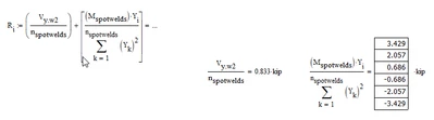

Arrays, I can't get the two terms to add up. i can get the results for each term
I can't get the two terms to add up. i can get the results individually. Attached is Mathcad 15 sheet. Thanks

Avoid inline evaluations.
Define the variable and then evaluate it in a separate region:
Werner_E25-Diamond IAnswer
Aug 27, 2023 9:32 PM UTC

ttokoro
Aug 28, 2023 7:04 AM UTC
Prime 9 converted.
