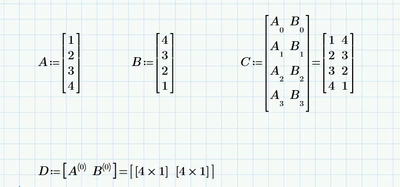

I have a matrix and i need to assign the first column as a second column in another matrix , can this be done without identifying each individual element?
In the example above id like to be able to create matrix D without having to specify every element from matricies A and B . Hopefully with the output as per matrix C.

solved with augument function

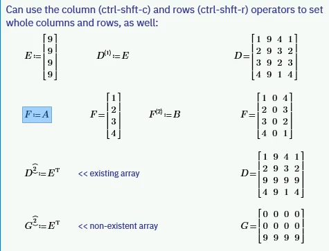

In addition to augment (and stack), you could also use the column and row operators to set entire array columns and rows, even if the array doesn't already exist.
