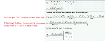

I am trying to assign the result of the symbolic solution of P to P so that I don't have to copy the result and assign it to P manually. See below and the attached mathcad file:
is possible to write this so that the result of P doesn't have to be copied?
I want to change this because if I change the formulas above, I dont have to re-copy the results

Why do you think that you can't put "P:=" in front ofW1=WE ... ??1
Put the cursor in front of the first "W" and either type "P:" or ":P". Both should work.
You sure will get an error, stemming from the numeric processor, which you can ignore.
Maybe  the result will not be displayed (not sure about that), but in any case P will hold the correct expression and to see it simply evaluate P symbolically.

You can simply define:
P :=  Wl = WE ------------>
With the "solve, P simplify" above the arrow.
The expression may show undefined variable errors, but the symbolic processor  will not mind.
If you want to prevent that, make P a function of all variables that end up in the solution:
P(Mu, k,.....) :=  etc...

the moment I write "P :=" I cannot write "Wi = We" right after in the same math box
edit: I was able to do it. I have to type only : and wait for := show up and click. If I type :=, it doesnt work.

thank you! as you said I have to type only : and wait for := show up and click. If I type :=, it doesnt work.
