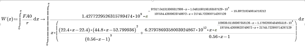

i am  having difficulty with the integration problem.
i dont even know mathcad can solve it or not.@
Thanks in advance

the symbolic itegration presents some difficulties.

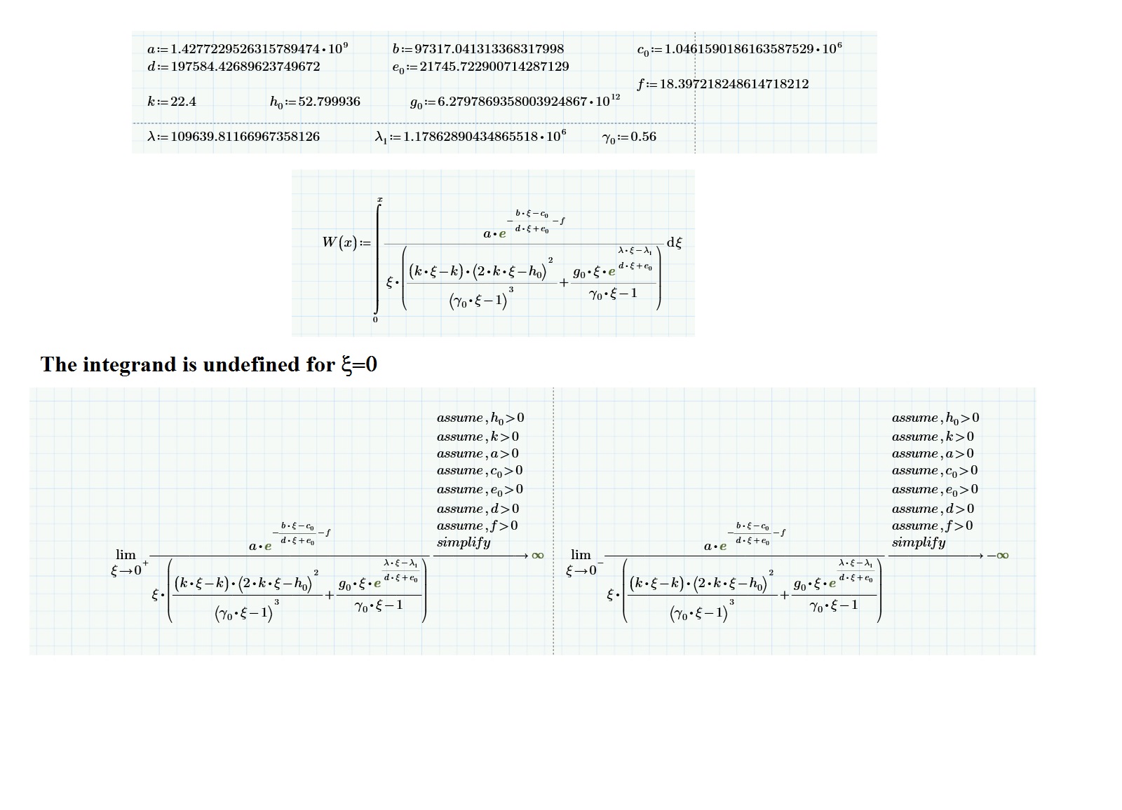

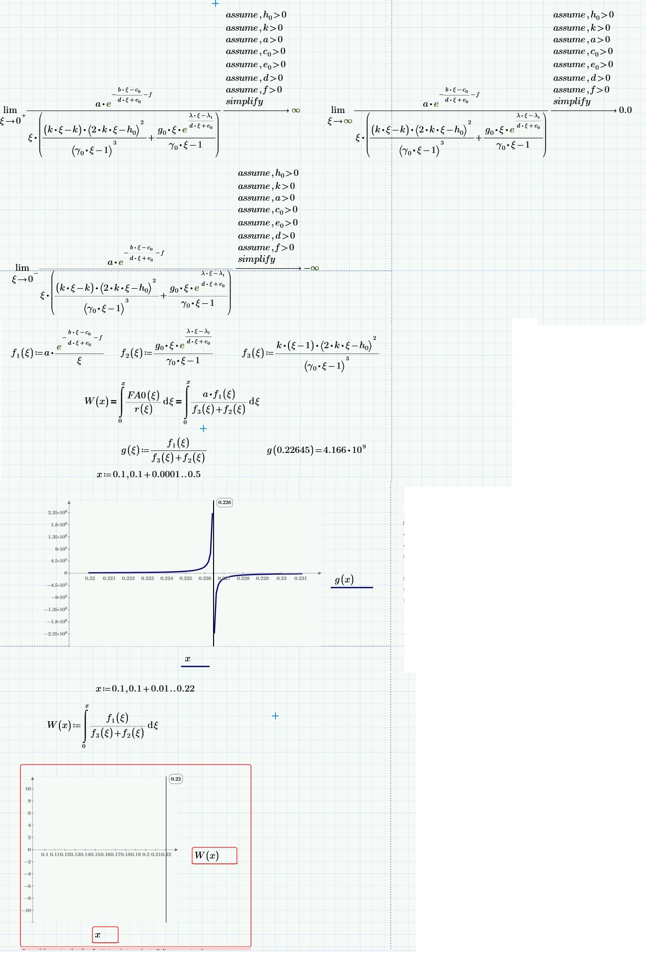

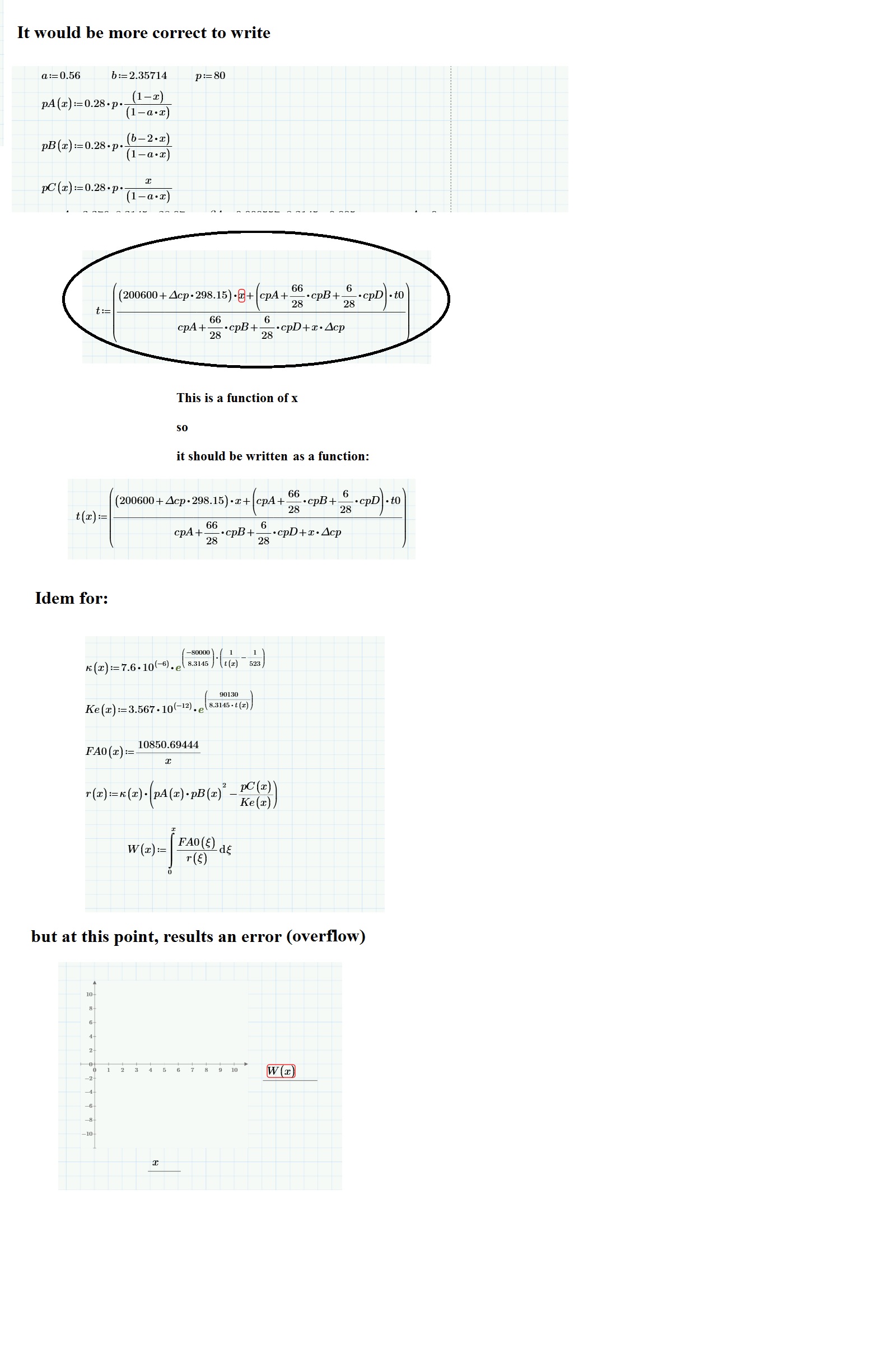

Start by separating the x of the integration limit from the x as integrand, e.g. by defining your function W as a function of z instead of x:
-MFra-21-Topaz IIAnswer

Thanks a lot  F.M. for your solution
actually what i needed was W(x) - x relation. Can I use g(x) - x graph as W(x) - x in a given range?
and can you pls insert your solution in mcdx. because i have to find W(x) - x relation for different t0's

Hi gvalishova,
I have attached the requested worksheet.
Greetings
F. M.
