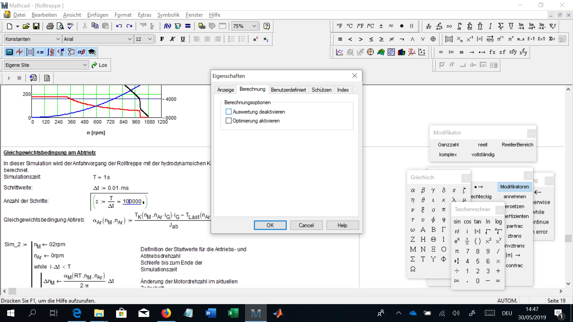

hallo, würde gerne wissen wozu diese Option ist? Auswertung aktivieren/deaktivieren....und wann man das benutzt ?
danke !

You'd use 'Auswertung deactivieren' when you are editing in calculations that take a long time to complete. That will enable you to move from equation to equation making changes, without being bothered by having to wait for calculations to complete between each of your single edits.
If all your calculation(s) are simple and fast, you can keep the setting 'Auswertung activieren'.

Thanks alot, makes sense !

I would add that when you want to print the worksheet, if it exceeds, say, 10MB, it is better to first disable the automatic calculation and launch the print preview and then print, if you don't do so there is the possibility that everything will hang.
