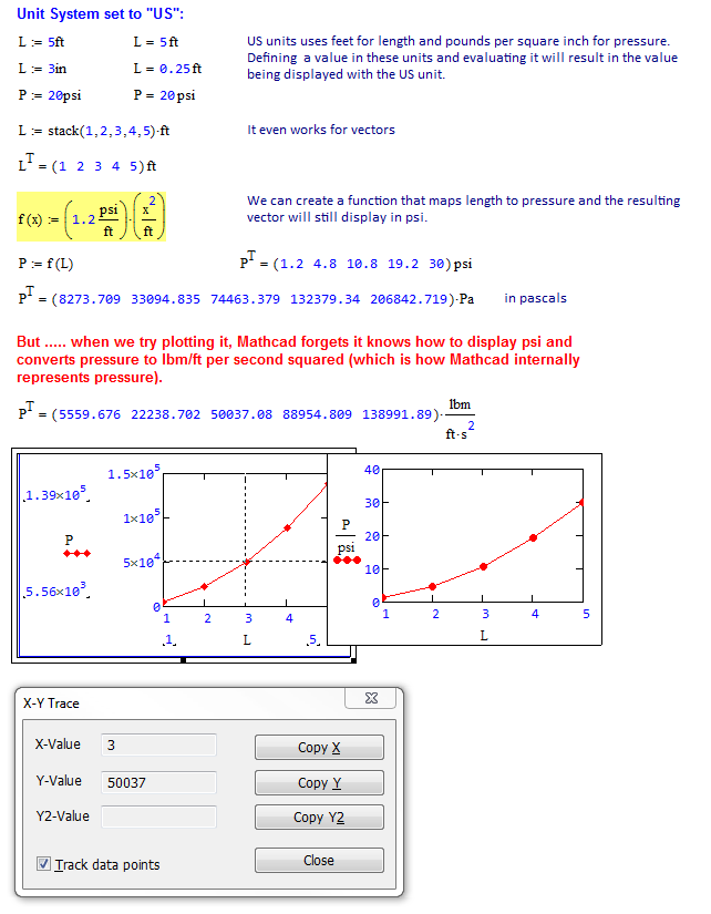

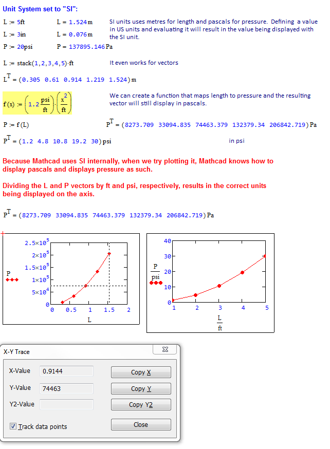

Werner's point is so key to understanding units in Mathcad that it bears repeating.
Mathcad calculates internally using SI units.
Although Mathcad (15 and below) has the ability to work in different quantity systems (such as CGS and US), the results may not always be what is expected due to how derived units are represented.
Look at these two examples:
