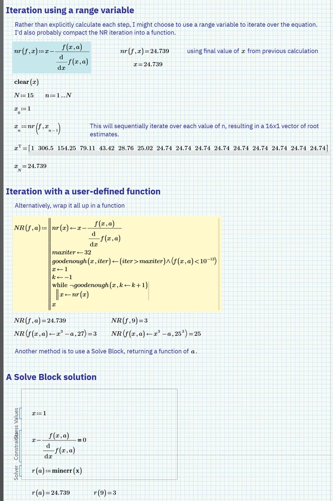

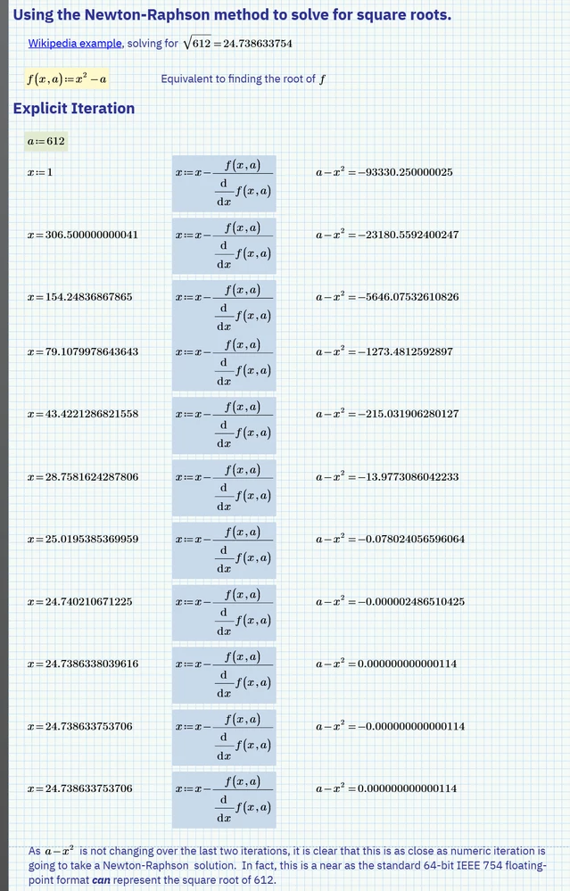

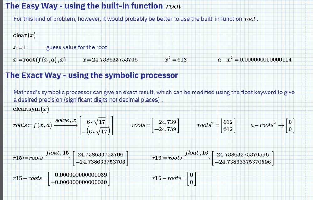

There are a multiplicity of methods of solving iterative problems within Mathcad.  Which one is best (for values of best) depends upon the nature of your problem.  Indeed, there may well be non-iterative solutions to your problem.   Here's a starter ...
