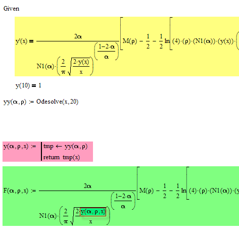

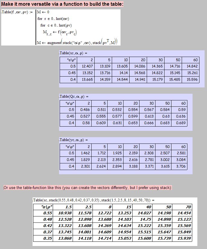

Hello everybody,
I have attached a MathCad 15 worksheet. I would like to make tables of the following parameters for 3 values of alpha and for different rhos.
rho values: 2, 5, 10, 20, 30, 50 and 60
x1c, x2c and x3c corresponding to alpha=0.50, 0.45 and 0.40 respectively.
Q1c, Q2c and Q3c - same thing.
y1c, y2c and y3c - same thing.
Please go to the "Xc, Qc and Yc Section" on the worksheet.
Also, I would like to make some graphs of these parameters.
Thank you so much for the time and help.
Anousheh
PS final results as an array would be OK. I guess, it can then be exported to excel. OR, can MactCad produce tables?
