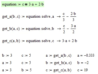

You may define the equation in the front and then let Mathcads symbolic create functions for each variable depending on the other variables in use.
Later you may use those function as you need.
Here an example with a simple equation.
Some more work may be necessary if your function can't be that easily and unambiguously for a specific variable.

What you want is perfectly possible.
Suppose the equation is
a=b+c
Then you define it e.g. with:
Equ:=a=b+c
(Where you make sure that the = between a and b is a bold one)
Then you can define:
a(b,c):=Equ -> solve, a
(Where -> solve is a symbolic command)
And you can define:
b(a,c):=Equ -> solve, b
If you need help, post your worksheet with any questions you may have.
Luc.

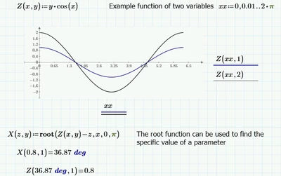

DO NOT use a global equals sign in a function definition!  It doesn't add anything useful.  In fact you should avoid (as much as possible) using the global equals sign--they tend to cause more problems than they're worth.
In addition to Luc's suggestion for using the symbolic processor, you can find the value required in a function (knowing all of the others and the desired result) using a solve block.  (Solve blocks only work in full Prime; since I have only Express I cannot supply an example.)  The root function can also be used to do this for some functions:
