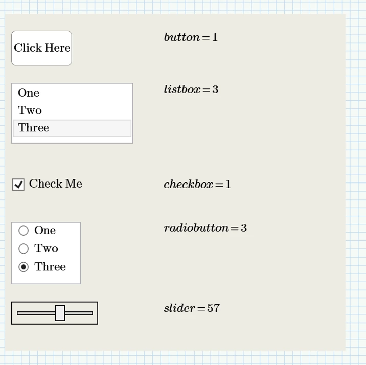

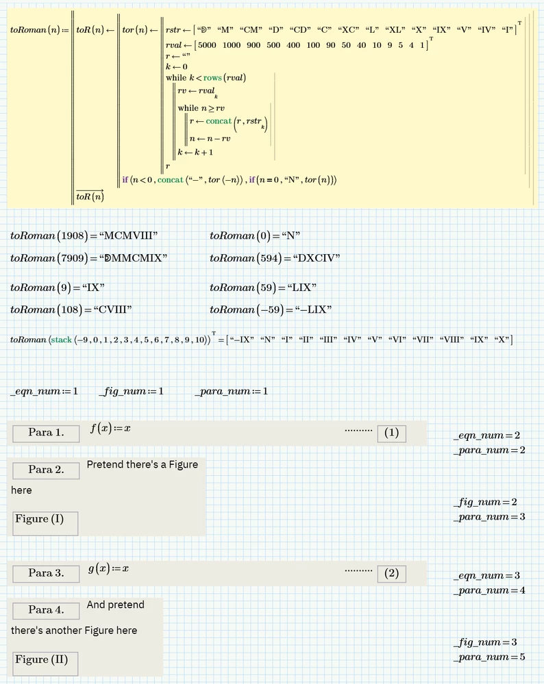

It's not ideal, but MP10's Advanced Controls allow a rudimentary form of entity numbering.
It's interesting how you can paste certain things into placeholders, etc, but not insert/type them directly (yes, 3-place range operator, I'm looking at you!).

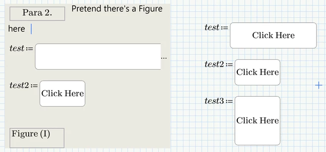

I asked because I noticed that we cannot create an advanced control in a text region but we happily can create a Text Box outside and copy it there.
When I tried the same with a button I ended up with a button stretched infinitely horizontally - impossible to resize.
After seeing you reply here I tried again and it worked flawless. Not sure what was going on last time.
EDIT
Ahhhhh!!
I was able to reproduce the error!
Create a button outside of the text region and before you copy it, resize it horizontally. Then copy it to the text region.
As you can see in the picture, copying a button (test2) which was not resized experiences not this problem, but it looks like we can't resize controls once they are inserted in a text region.
This all smells like a very bad bug.
BTW, don't try to copy a button which was scaled vertically (test3). You have been warned!
