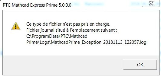

Mathcad close automatically but an automatic save has been created. Othewise, the file cannot be open, see the warning message and the file in attachment. The extension is good and the file is not empty (8646 ko).

The file is corrupted.
Try to get support from PTC to correct this problem their application has created.
Otherwise (may be faster), use the last backup you made of the file that still functioned, and work from there.
