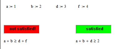

I got from some old, long forgotten   training course the following (here very simplified) example of a scripted automated change of colour and text depending on a Boolean condition.
This is to me pretty useful, for example when there are many requirements that I have to prove all satisfied for example for a structural verification.
The only "problem" in this implementation is that the condition appears under the "traffic light" red / green message.
This is because the Arguments have to be under the box.  I would definitely prefer having the coloured text message either on the right of the condition, or under it. Because it is a logical consequence of the condition, so the reading should go from left to right and downwards.
Of course I could define a dummy variable containing the condition and then use this one as dummy argument, and then "hide the arguments". This is a little error-prone when ones makes many cut-and-pastes.
This is admittedly a low priority aesthetical question...

How about hiding the arguments of the text fields and either writing the conditions twice or assign it a variable?

I use pictures for this. And the if operator. Without scripts!
Thanks to Werner and Valery for the answers!
I will go with Werner's method, that is actually what I also was thinking... somehow I do not like to duplicate expressions ...they have the bad habit not to change both when you change one of them .  (I used to be a FORTRAN programmer, a lot of time ago... some habits are deeply rooted...).
The variable assignment followed by hiding the arguments seems, for my needs, the best solution.
The idea of Valery is genial, I would have never thought of it! But it is less flexible (changing the text for example) and it still has the same problem that the condition appears under the image (my original question).  And it would force me to "distribute" the picture files too, if I want to let someone else use my Mathcad-Worksheet.  On the other side, it does not need scripting, that is a bonus. Someone could appreciate that.
I have implemented it too in the attached file (and of course one needs also the two jpegs).
