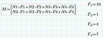

Hello everyone,
I am trying to automatize a calculation process in Mathcad, but I am having some difficulties doing it.

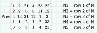

Lets say I have a matrix with “n x m” number of rows and columns.
In this example we can have the following matrix (5 x 6 – but it can be different, ex: 10 x 15, 9 x 10 etc...):
Note that Ni is each row of the matrix.
There is a variable “var” that can be equal to 1, 2, 3 or 4.
And finally we have vector “V” (that has always 1 single column, but number of rows depends on the variable “var” however this vector is an input, the values below are just an example):
I want to obtain the following matrix “M” depending on the variable “var”:
- If var = 1 (“V” vector will have just 1 row – F1 = 10)
- If var = 2 (“V” vector will have 2 rows – F1 = 10 / F2 = 1)
- If var = 3 (“V” vector will have 3 rows – F1 = 10 / F2 = 1 / F3 = 4)
 - Finally if var = 4 (“V” vector will have 4 rows – F1 = 10 / F2 = 1 / F3= 4 / F = 7)
Any suggestions?
Thank you so much for your help,
Miguel

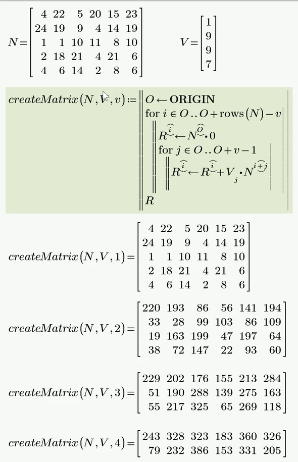

May 25, 2022 12:24 AM UTC
Not sure, but is it this what you are looking for?
EDIT: Attached a new screenshot as @terryhendicott  had noticed that in the previous one Prime had not displayed the newly created matrices N and V correctly and so the results looked wrong.
Worksheet in P& format attached

Werner_E25-Diamond IAnswer
May 25, 2022 1:25 AM UTC
Good observation, thanks!
Actually the program seems to do the job but for some reason Prime managed to update the creation of the random matrices V and N and using them in the function but did not  update the display of N and V. Actually this should never happen (and never did in MC15 and below).
So a hard recalculation of the worksheet fixes this inconsistency which I had not noticed. Thanks for bringing this to my attention.
I attach a new screenshot in my first reply and also attach the worksheet (even though the OP didn't).

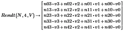

23-Emerald V
May 25, 2022 6:49 AM UTC
So you want to create a specific matrix, namely a vector, from a matrix, a vector and a variable.
If the matrix is this:
The vector is this:
and the variable is 1 you want:
if the variable is 2 you want:
on to, if it is 4 you want:
That can be easily accomplished by this simple function that also works in Prime express:
A numeric example:
Prime 4 file is attached.

23-Emerald V
May 25, 2022 8:39 AM UTC
Ah, I see where I went wrong. A small correction is needed:
Now gives:
and
Which meets your description in the original post.
I understand that that description apparently does not match with what you intended...
