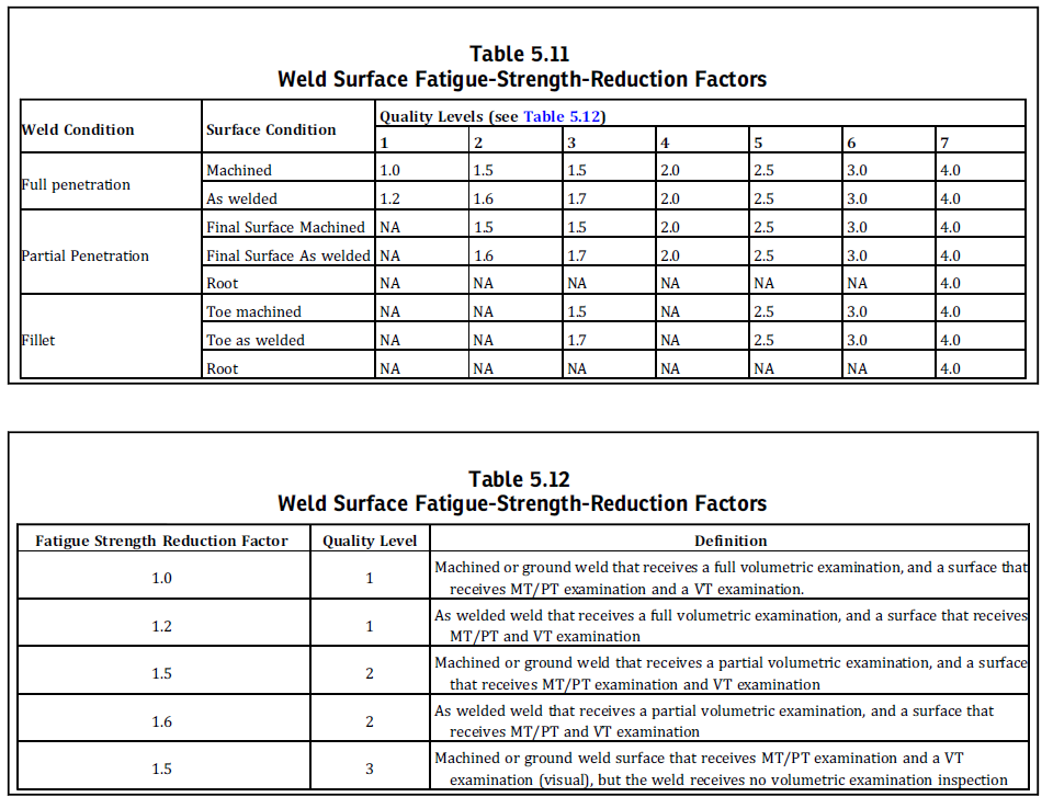

I would to create a calculation sheet in Mathcad 15 where when I select an option the reference value are automatically selected.
For example:
In the previous table I would select the value determined by weld condition (full penetration) and quality level 2.
I would to create  a windows that, when I select this two condition, the referring value is automatically selected.
Best regards
Stefano

What do you define as the 'reference value' or the 'referring value'?
If in table 5.12 select 'Full penetration' and a quality level of 2, I still have to choose a surface condition between 'Machined' or 'Welded' to arrive at a single Fatigue strength reduction factor.

Hi Luc,
I would create an automatically option into Mathcad to select the reference value. I mean the output value obtained by the input selection.
For the example in table 5.11 if I set Weld condition (full penetration) and surface condition (machined) and quality level  1 that are the input data, I would to automatically obtain the ouput (reference) value equal to 1.

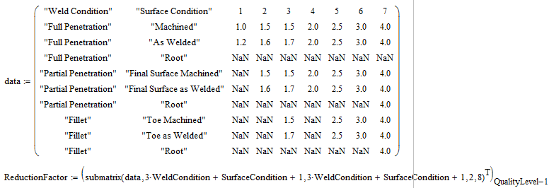

But then, you might be looking for something like this:

I was just working on such a solution for you:
With this in a hidden or non-printed region:
File attached.

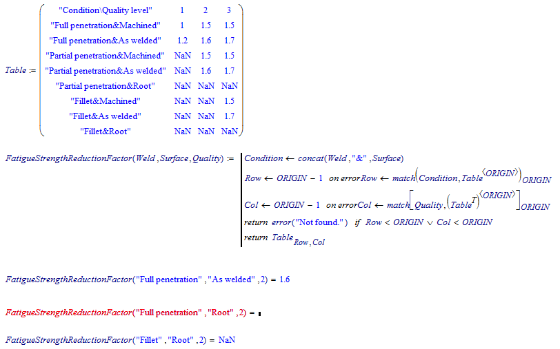

November 16, 2016
This is how I did it in Prime.  I assume something similar works in 15.  Note the use of strings.
