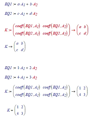

This is possible in Mathcad 11.
The possibilities in Mathcad 14, 15 are generally less. Maybe you are lucky in Prime.
Regarding Matrix B: You can create (almost) any matrix with (almost) any filling you like.

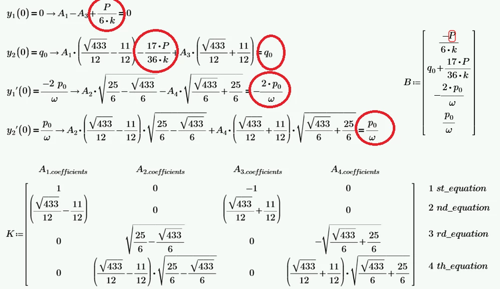

Matrix B comes from free expressions in these equations (it is a right side of equations)B.png

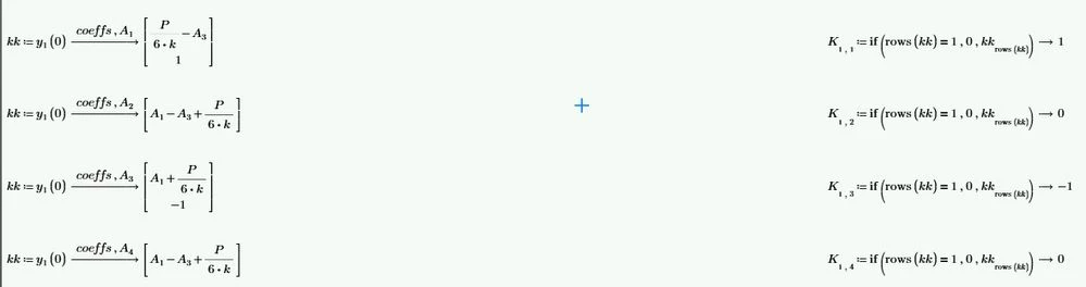

Mathcad can't recognize COEFFS command when equation is with equal sign...=.PNG
The only way i have any idea is it:HOWTO.jpg
But still no idea to create B matrix. For example B(1)=P/6k, and kk(1) is P/6k-A3 (I can't do "kk(1)+A3" because the value can be another)
So still i have no solution...
