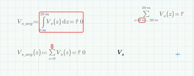

Your integral appears to fail because you have an evaluation ( the =  ) after the definition. That often results in problems.
If I delete that =  (and delete the never ending program you wrote to create an array) I get:
I agree that inline evaluations often are the cause for problems, but this time the reason for the failing is the zero which was typed in the "placeholder" for the unit of the result 😉
Delete your second definiton of V.s
The attached sheet should help
