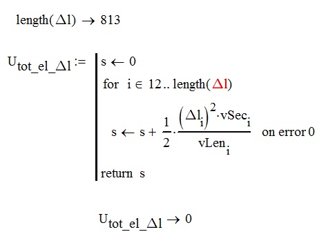

Thanks for reply Fred,
sorry but i'm not sure how to use on error . I've tried like in this screenshot, simple adding "on error 0" to the line of formula.
hoping that in this way when div by zero appear 0 is stored instead of 0.5 * vSect(i)*Dl(i)^2 but it dosen't work.
Could you suggest the right usage ?

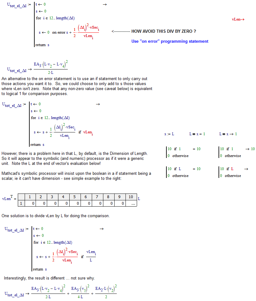

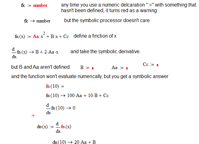

23-Emerald I
Stuart showed you the correct syntax for "on error".
Sometimes red is just the numeric processor complaining that a variable hasn't bee defined; but the symbolic processor can carry on.

As Fred Said ...
Stuart
Sorry Stuart,
your code is very clear.
But when i write in sheet, Dl vector is red (undefined);
the formula after on error is all black , different from your screenshoot where is all red and Dl vector is blue (and not red).
As a result : U_tot variable is always zero.
It's clear i'm doing some big mistake but i don't understand.Screenshot 2016-06-20 18.01.19.png
23-Emerald V
Nicola Iacopetti wrote:
Sorry Stuart,
I can't see at the moment why that should be, as all I did was modify one tiny part of your worksheet.  However, an alternative to using the on error statement is to simply use an if statement.    Life isn't simple - even this has problems.
