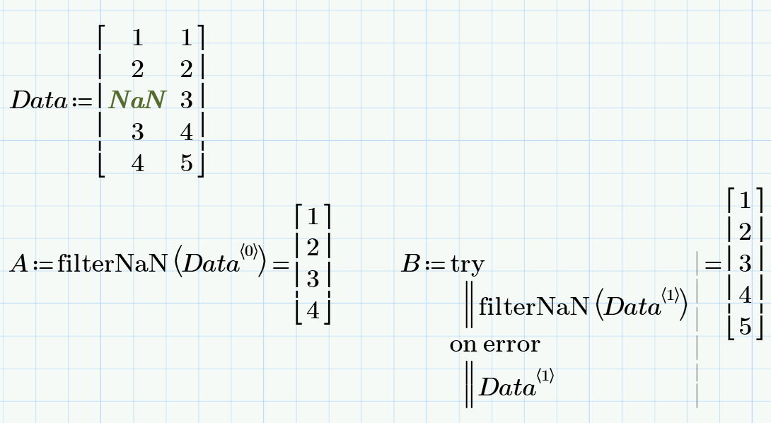

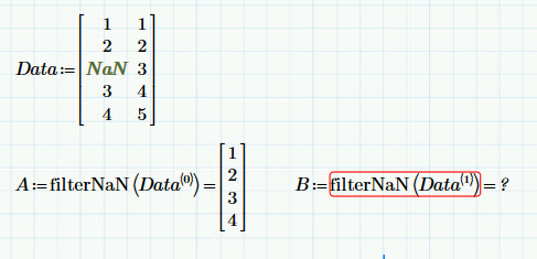

I have various data sets I'm performing some analysis on. Sometimes they have blanks, sometimes not.  I can easily filter out the blanks with filterNaN.  The problem is if there are no blanks the filterNaN errors out.  So, I have to rewrite the statements for each column as to whether I need to filter or not.  I'd like one command that works whether I have blanks or not. What are my options?  Here's a simple example:
Here, I want to return B = [1 2 3 4 5]^T

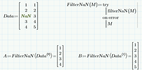

Write a short program with "try..on error"

MJG1-VisitorAnswer

That's a very elegant solution.
