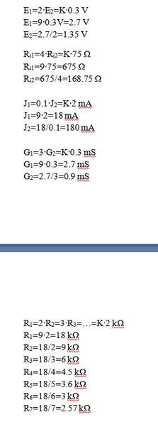

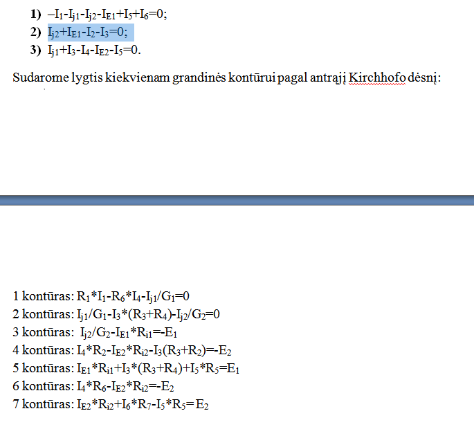

8bdf4fb1efac5f6dab5948e1f2ad937eI've been trying to figure out how to use mathcad since I didn't have any lectures about it in my university and I'm asigned a task that says to solve the equations by using mathcad. Could anyone help me out?
I've pasted 2 photos of variables that we know and equations from which we need to find I1,I2..etc

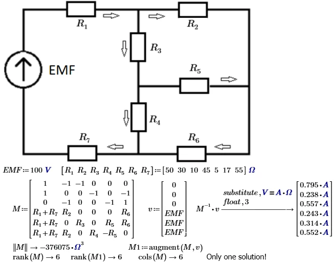

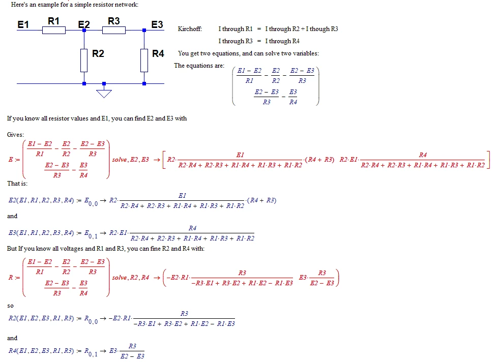

With this example, you should be able to enter your stuff.
Don't hesitate to come back (reply in this thread) if you run into trouble with the use of Mathcad. In that case, attach your Mathcad worksheet file, not just a picture!.
You may have to zip the Mathcad sheet first. A serious bug in this forum often prevents from attaching a mathcad file. In Windows Explorer click with the right-mouse button on the mathcad file and select 'Send to' -> 'Compressed (zipped) folder'. The resulting .zip file can be attached.

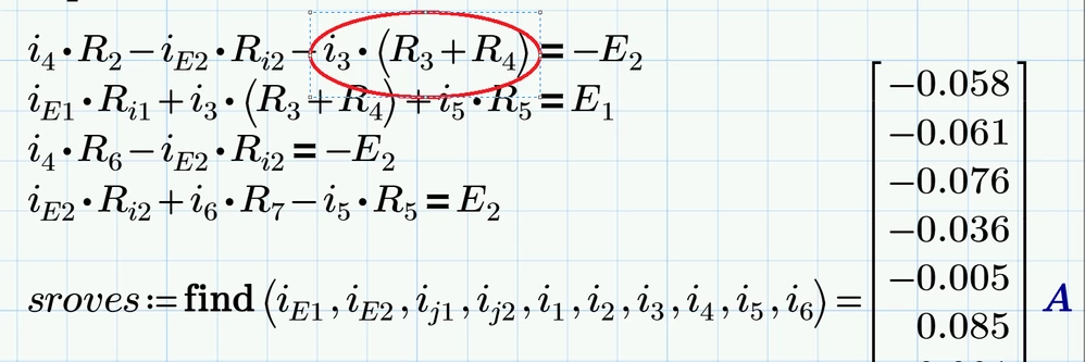

I've asked what I did wrong here, and the only thing was that I didn't describe unkonwn variables in my case. And yes, the pictures are from a word file.
But now that I have an example and tried almost copy paste it to fit to my project I get an error with a command Find. The error is "This value has to be a function". I have no idea what to do again... Any tips?
I'm attaching my worksheet
March 14, 2018
LucasL1-VisitorAuthor
March 14, 2018
Ohhh... I'm sooo blind. Thank you very much!!!
