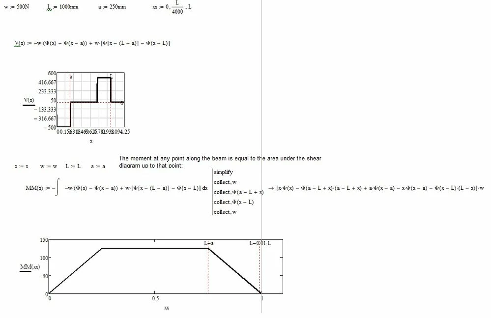

I have started drafting some material for student engineers relating to bending moments and shear forces. Initially,  the SF and BM were calculated long hand and the plotted graphs look correct. However, when integration and differentiation is used the graphs are not correct. I am using M15 with Windows 10.

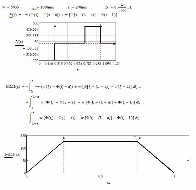

I broke the definite integral into three parts and the defect disappears, look here:

I will go on so:
I have tried this and still get the same error. I have just modified the functions and swapped the 'otherwise' statements to 'if' as shown below:
This has corrected the differentiation error when plotting the shear force diagrams, but there is still an error with the bending moment (MM(x)) plot when integrating V(x).
Good work and thanks for the effort.
Could you please post the worksheet so I can investigate further?
