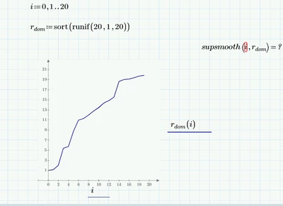

Hi
Help with smoothing function please.
I am having issues formulation a smoothing function. Errors like "This value must be a vector of real numbers: pop up.
A working example will help a lot.
Prime 6 File Attached.
18-Opal
March 28, 2021
l having problems plotting.
Mathcad and Excel file attached for your help please.

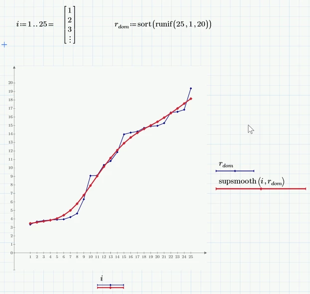

Your approach failed because i is not a vector but a range!
In the pic below I used an undocumented trick to turn a range into a vector by adding a numeric evaluation when defining the variable i. Furthermore I chose the first value to be 1 instead of zero so the magnitude of i and r.dom match.

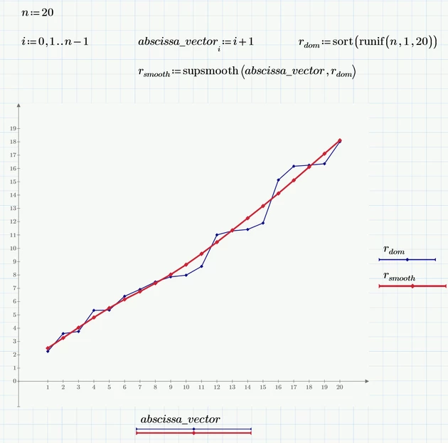

But of course you are on the save side if you define the necessary vector the "legal" way:
A working example can also be found in the help
https://support.ptc.com/help/mathcad/r6.0/en/index.html#page/PTC_Mathcad_Help%2Fexample_adaptive_smoothing.html%23wwID0EFBUV
You may also be interested in the information about smoothing in the MC15 help. Find it converted to pdf in the attachments.
