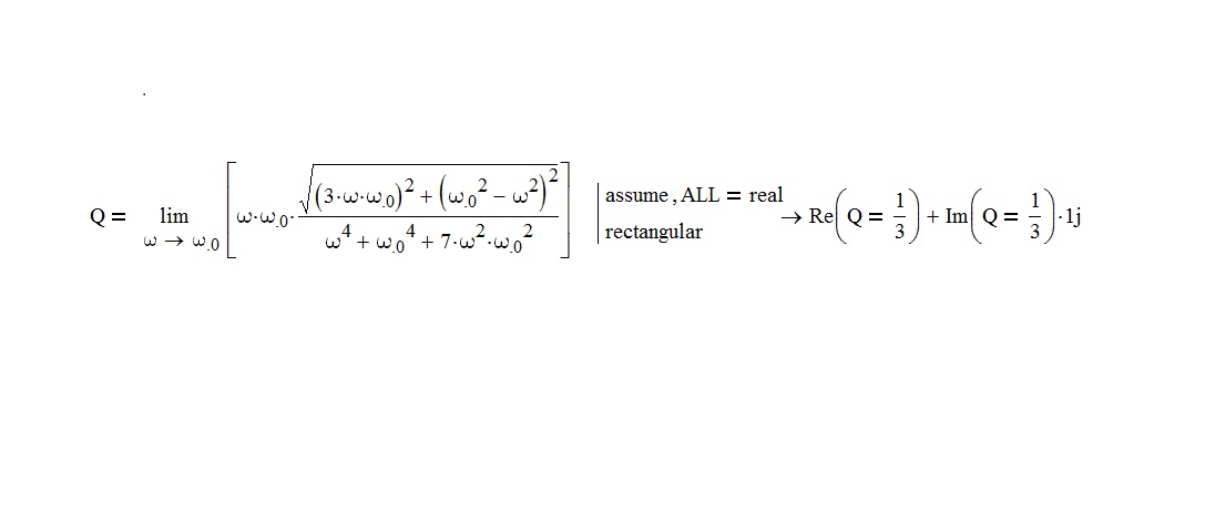

Hello everyone. There is someone who kindly can tell me what to do to get a better simplification?
Werner_EAnswer
March 11, 2016
You are symbolically evaluating an equation, not a math expression, and so the result can only be TRUE or FALSE, in Mathcad thats 1 or 0.
The rectangular command applies to the result of the whole calculation (0 or 1).
So if Q=1/3 is TRUE (1) we have  Re(1)+Im(1)*j=1+0j=1 -> that's TRUE
If Q=1/3 is FALSE (0) we have Re(0)+Im(0)*j=0+0j=0 -> that's FALSE.
So Mathcad is perfectly right - it gives you the truth value as commanded in rectangular form.
What you expected to see can be easily achieved by "assume, omega.0=real" or, if that applies, by "assume, ALL=real".
Sometimes a "simplify" or "simplify, max" is additionally needed and ever so often muPad refuses to give us the results we expect and need - bad luck.
Werner

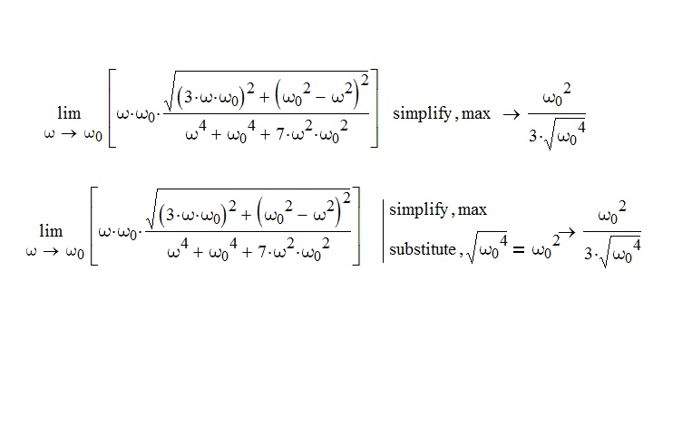

If , however, I write the expression as in the figure, mathcad gives me an unwanted response. You can do something to get the correct solution?
Thank you very much again.
F. M.

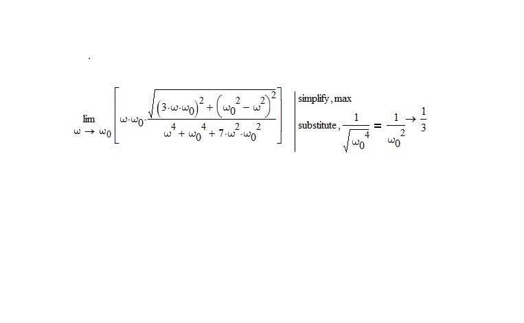

Done! thanks anyway!

March 11, 2016
Thanks for the tip!
F. M.
Werner_E25-Diamond IAnswer
March 11, 2016
Werner
-MFra-21-Topaz IIAuthor
March 12, 2016
Thank you very much. ...
The solution was so simple ...
trying again and again we'd all arrived ....
Greetings
